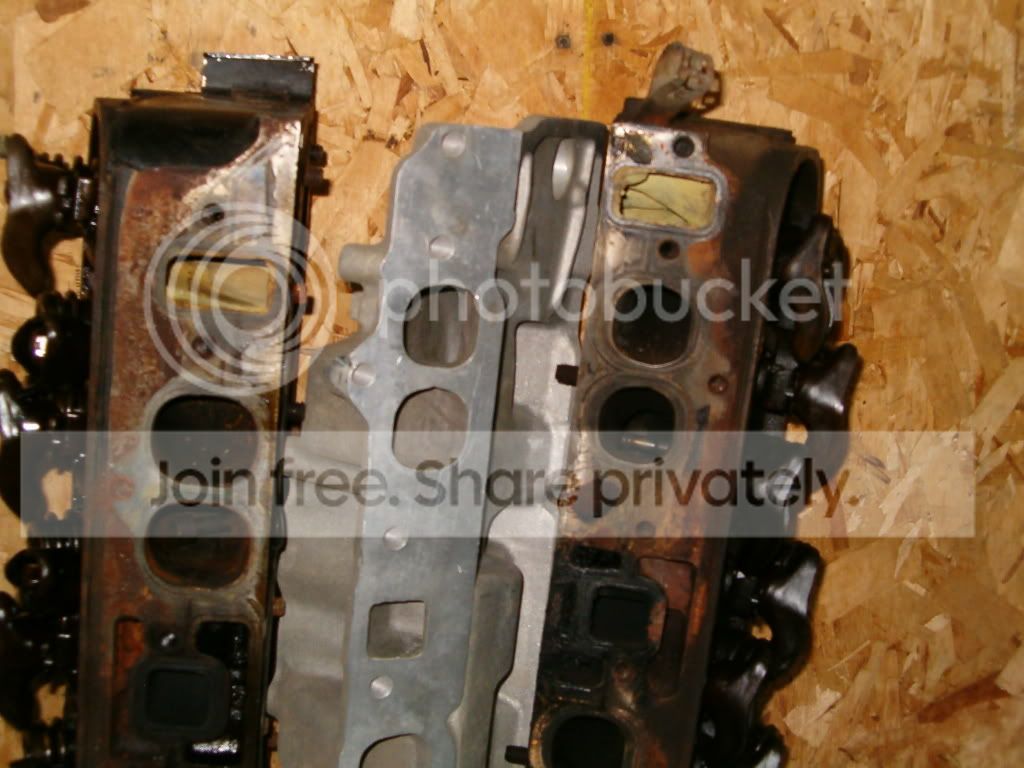

Did you happen to make sure the intake and head ports are the same design and not different? Have you checked the base timing? Compression? Hows the spark?
that performer intake needs a lot of work to match the 781 heads...
Head and intake ports are same design. The intake ports were slightly smaller ont the man. vs. the head.

I dont even think you can match the small circle ports to the ovals, I think it will grind into a water jacket or intake runner. I had to do quite a bit of grinding to my intake to match my newer style roller block heads.

They will make plenty of low end torque...open that performer up to match the 781's and let it fly. It can be done without hitting water jackets, my head guy did that same thing for my 781's. If your keeping the stock short block, maybe shave the heads .010 and get a thinner head gasket to bump up the c.r. some.
