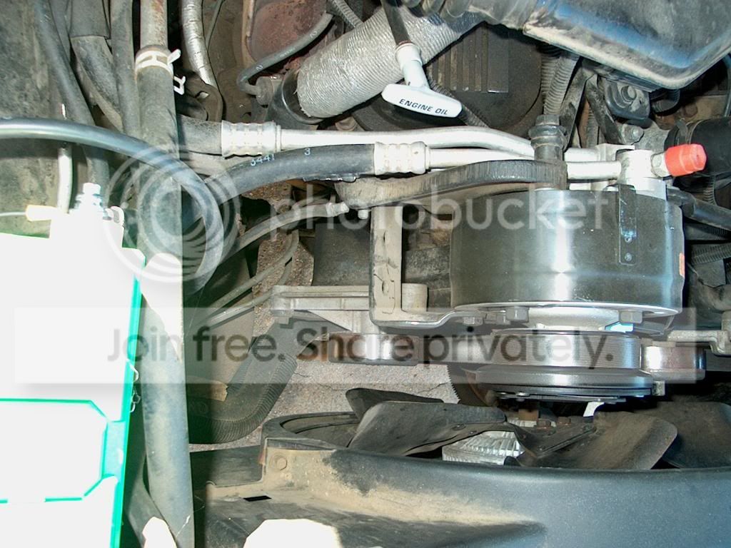

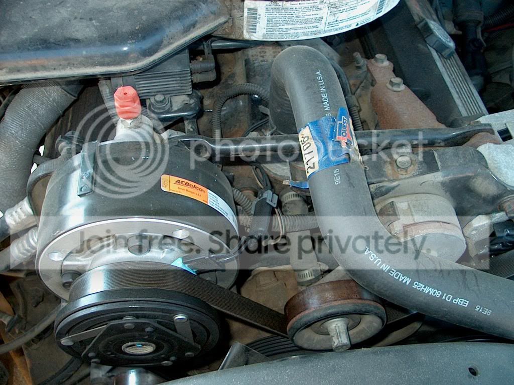

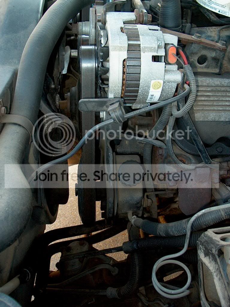

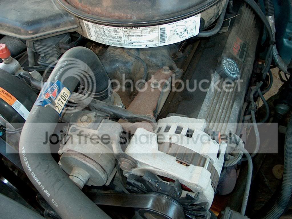

It looks like them. I have all the pics on my computer that I can send you of a complete serp setup. I went with the kwik brackets on my 454.
Here is some pics
Very helpful! Thanks! I just hope I got all the right things with it. Picked it up this morning.
awesome pictures! thanks!
