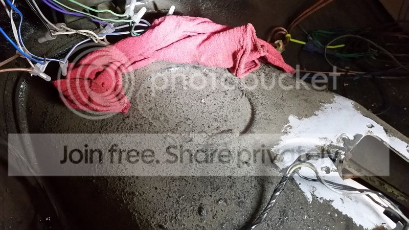

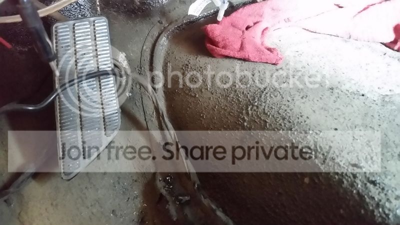

The transmission hump...mine is clearly spot welded in and so far ive found most of the welds to be 2.5" apart. Is the portion closes the engine bay spot welded all the way around? That means i have to take the dash out to drill straight?
Also does the indented portion get cutout for the shifter? Any recommendations on a boot for that?
The indent is for the shifter hole.
Never seen seen a hump spot welded in, only bolted or glued with seam sealer stuff.
Ok so i can blow that out once i get the damn thing out.
Yeah ive heard of a few people saying theres was spot welded in. Theres no doubt thats what im dealing with. Whatever glue is under it was un-phased by a blow torch.
