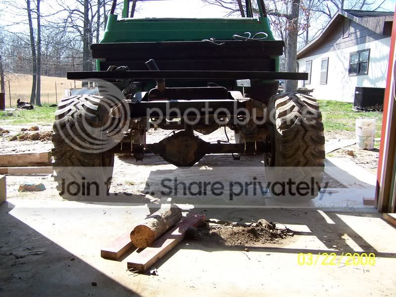

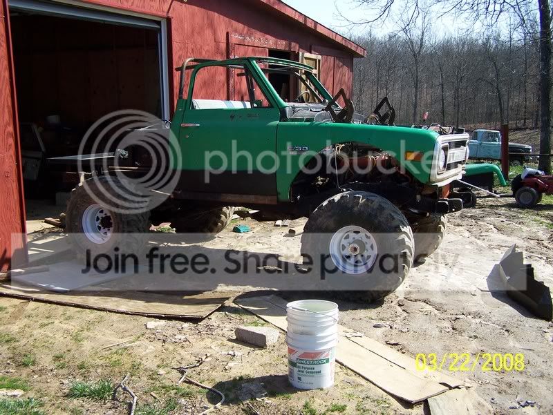

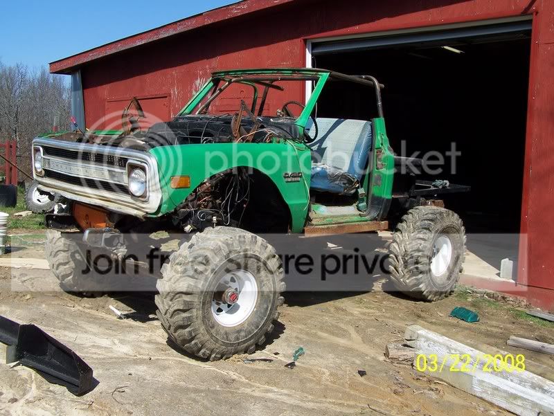

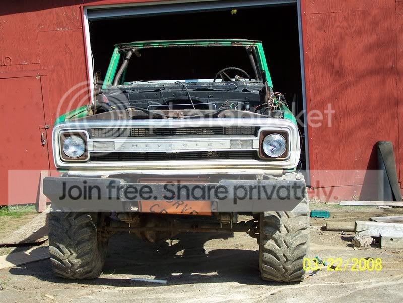

This is the replacement for my old 45 chevy. Work in progress....
The roof was rusted out so off it came, then I built a crappy cage that I am going to rework.

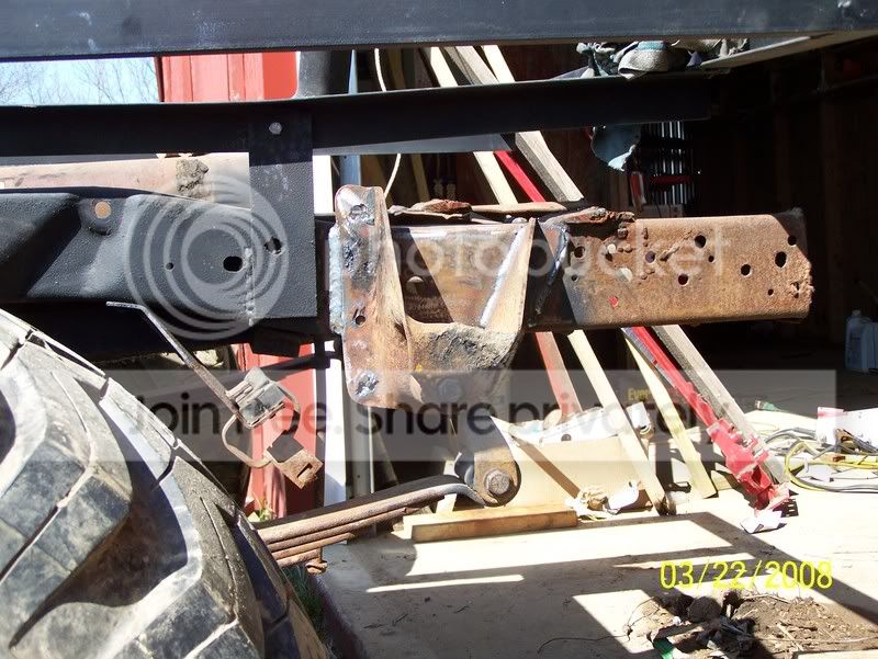

The truck frame was shortened to a 106" wheel base with the cab pulled back about 6" it is sitting a 4" lift which might be removed infavor 52" springs. rear is a shackle reversal made with 2wd front brackets.
I need to finish plumbing up the brakes and wiring, then I can work on making it nicer.
I am keeping everything off so that I can keep the weight down.
Looks good. i would suggest however that you drill your rear hanger & frame and runs some bolts in there. bolts are stronger then welds. Just my $0.02.
that is already in the works, the truck is not even half finished with what I want it to be.
