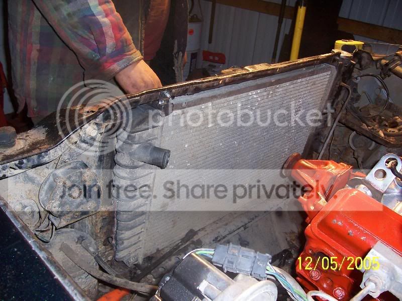

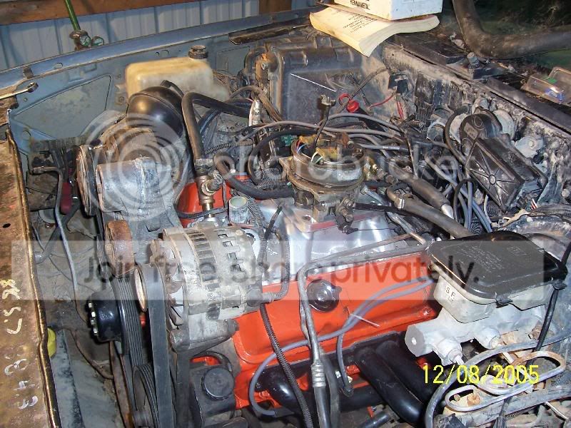

it took a little bit of work and parts to get it in and running, but its nice. i had to mod the radiator support so we could fit the factory 4.3 radiator inside it (everyone said it wouldn't fit)
but it fits nicely.

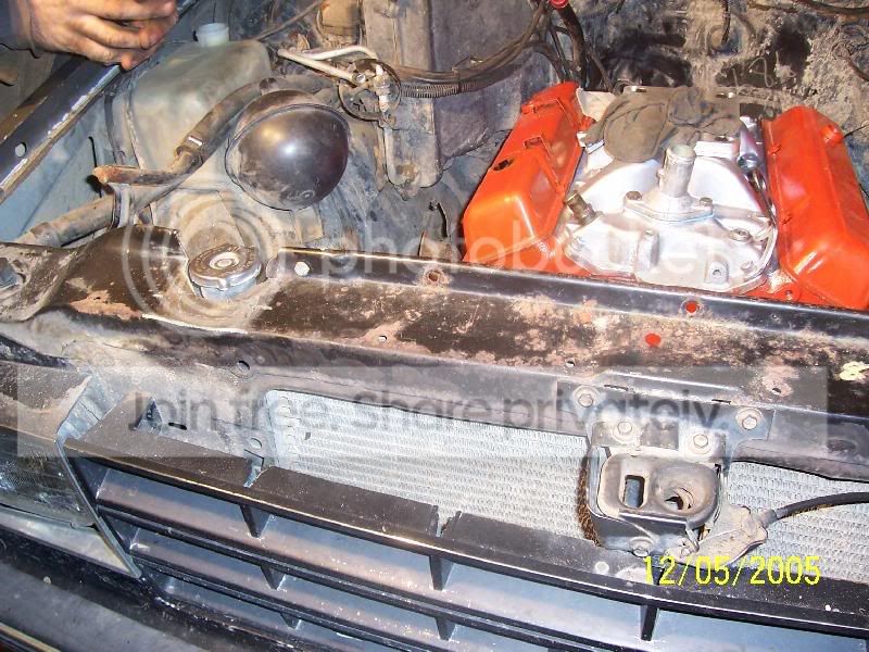

here you can see where the radiator cap is

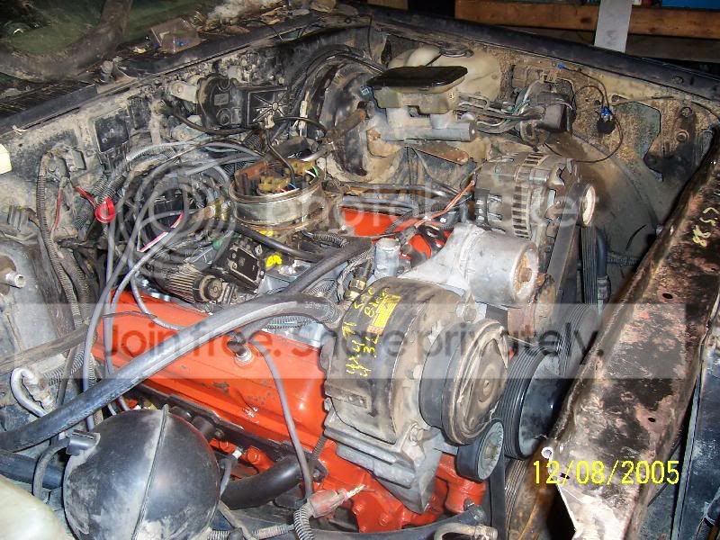

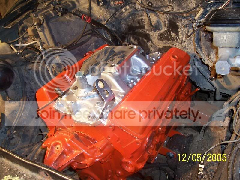

with the motor sitting in there, it looks like it will fit no problem
but once you get everything on it, the motor gets bigger.

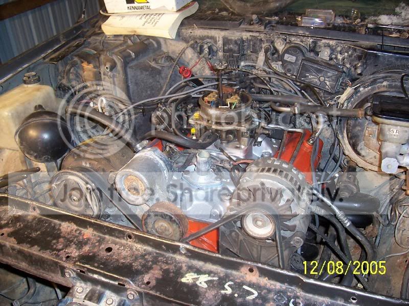

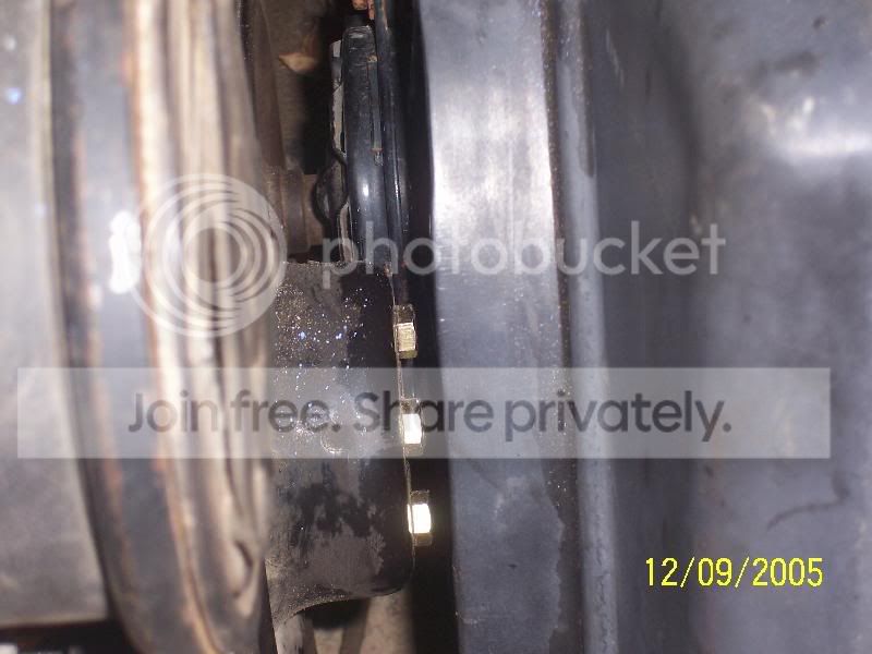

we used a ford taurus fan, with the motor set back about 5/8", this is the clearance we have on the fan/water pump pulley bolts

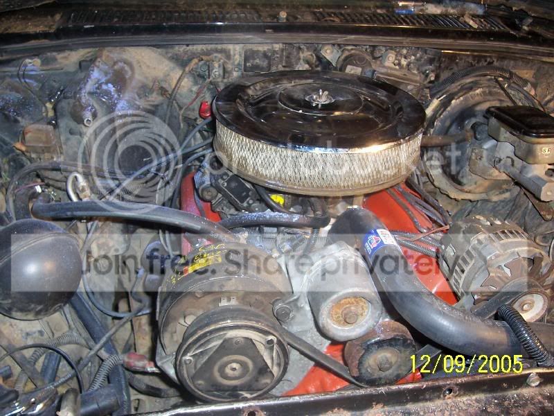

we had to cut the underside of the hood to clear the aircleaner and the air cleaner stud.
here it is finished
we still have some issues with the TBI, but it runs nice.

yea its a really tight fit. there was only one position for the motor to have the headers clear the shocktowers and fuel lines and such, and we still had to dent a tube on the pass side header to get it to clear.
