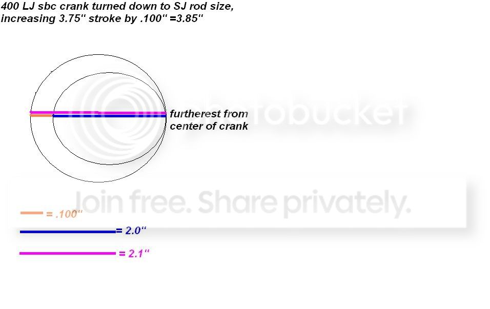

I've read about using a 400sbc block & crank to make a 427 cid sbc
basically, you turn down the 400 rod journals to 2'' sj size ..removing material only on inside of the throw..like this
then use sj rods(nascar rods 1.88''), so should be ok at 2'' and a .040 or .060 overbore block, can't remember which.. supposed to be 427(whats the math to figure cid w/bore&stroke)....

Math for displacement (for a V8, all dimensions in inches)
Cid = 2*3.1415*(Bore^2)*Stroke
So 2*3.1415*(4.185^2)*3.85 = 424 cid
(4.185 bore is a 0.60 over 400 block)
BTW, if you take 0.100 of the crank by offset grinding, you can't quite get a 0.100 stroke increase. Some of that is needed for cleanup, you might get a 0.080 stroke increase.
You would have to select pistons for the correct bore (shouldn't be too hard) and with the correct compression height with the rods you use (might be tougher).

Now, onto the question at hand. You can only offset grind a SBC 400 crank enough to gain about .080" of stroke and that's using .040" undersize rod bearings. If you offset grind the journals to standard size you can only gain .040-.045" extra stroke. With a 400 block bored to a max of .060" overbore and offset grinding the crank using a .040" rod bearing you will only end up with a 421 CI engine and no room for future crank grinding or for a rebore. You will also have to use a special piston since the 5.7" length rod is going to push the piston upward an extra .215" and to be honest i don't think you can even do that so that means a special rod will be needed along with a special piston to come up with the correct combination to get the piston to the top of the cylinder without going beyond the deck.

"Clipping" the cap will change the ID bore diameter by a few thousanths of an inch. It is impossible to remove enough material to make a 2.225" diameter hole 2.125"
