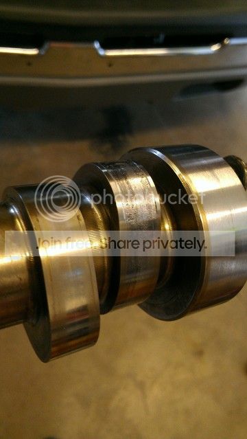

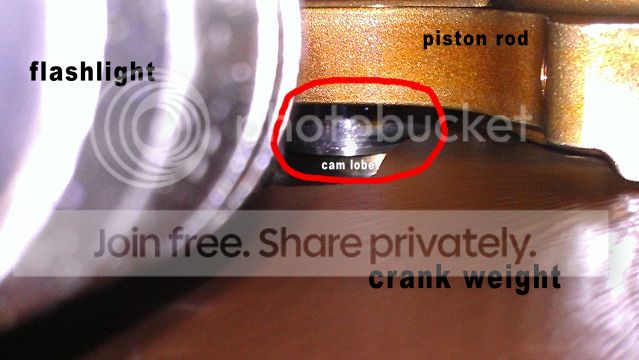

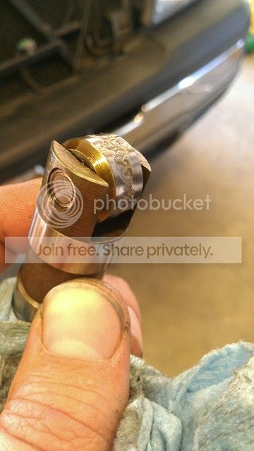

I had something similar several months back, had the oil pan off twice until I looked harder and noticed a scraped up cam lobe. Turned out to be a worn out lifter wheel and chewed up cam lobe.
