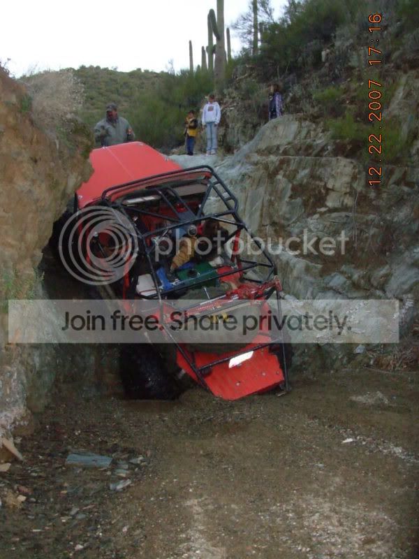

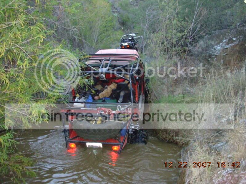

:D Thanks Rene. I know Joe ran some deep water and mud in his truggy even though he's a Cali guy. Fred may have went through a puddle or something down there:wink1:
Thanks for the replies so far.
Just a puddle or 2... Nuthin like the old guy from Canada:haha:
