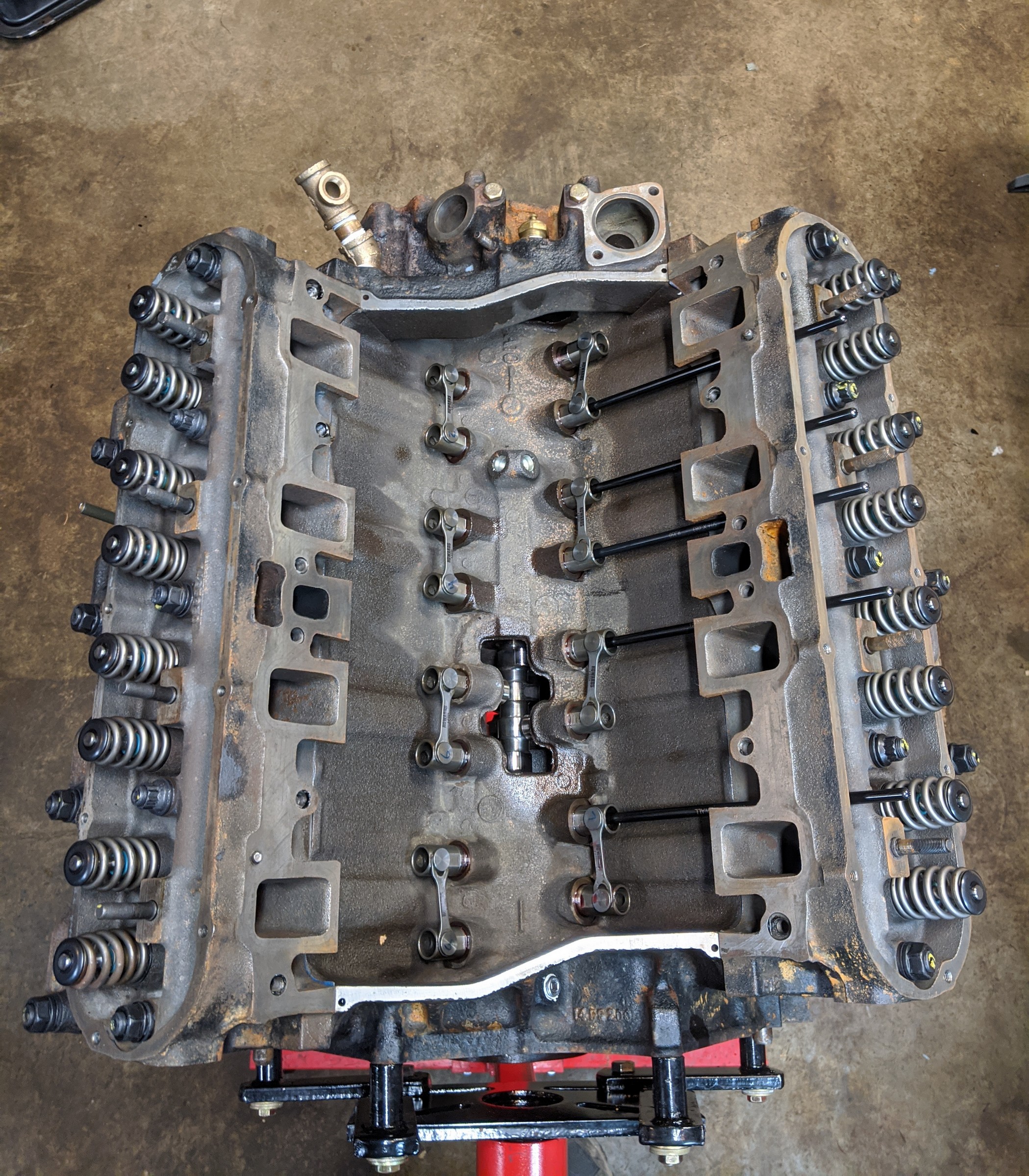

I ran a 75 Cad 500 with the SM465 behind it. Absolutely loved it. Ran 35" tires with 3.73 gears and got 15 mpg. I had to have the crankshaft drilled for a pilot bushing. 9/16" Depth for the pilot worked. I had a radiator shop modify my radiator to mimic the Cad setup. There is a coolant outlet by the passenger side head that creates a tight fit with the firewall. A 90 degree elbow solves that. Slight modification to the firewall with a BF hammer improved distributer access. Wish I kept that truck.
Speaking of stupid problems, there is a shortage of places to get coolant temperature. And there isn't a good way to move water if you don't want to use the head (and I didn't). So I used brass fittings!

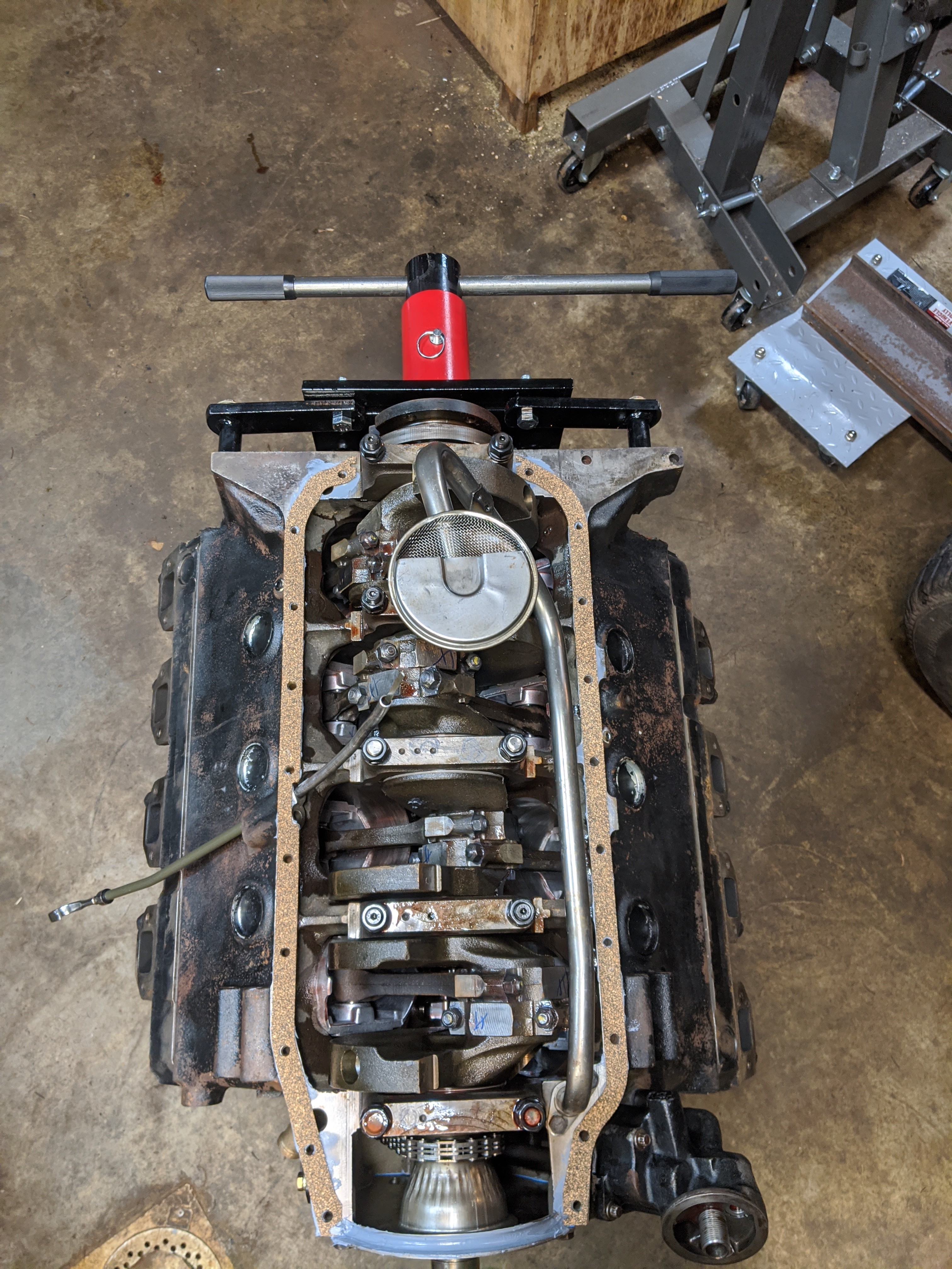

Just an update. Chris at Cad Company is the man. Via email he's literally provided me with 2,000 words of diagnostic gold. Thanks a ton for that recommendation.
He does say it's a bit of a tricky description, but I'll keep going down the path and fill you all in on what I come up with.
And thanks for the great pictures. That helps a lot in visualizing.
Now, to figure out how to drop the pan without removing the engine/trans...
