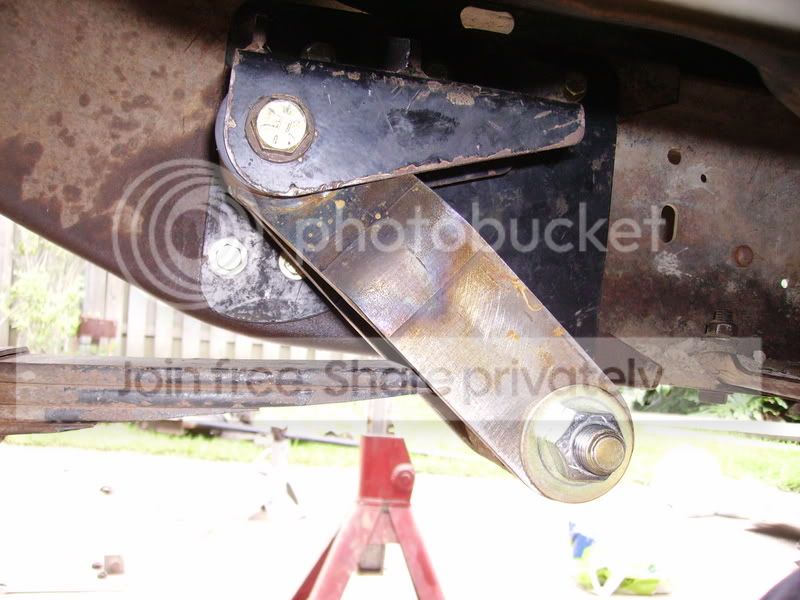

no i tried them and they gave me 2-2.5" of lift and maxed out my shackle... the spring wraps to the top of the bushing and they ended up squishing pretty flat even though they where like a 6 leaf pack and ended up being closer to 53.5" long which maxed out my 7" shackle and in general where just a bad idea
