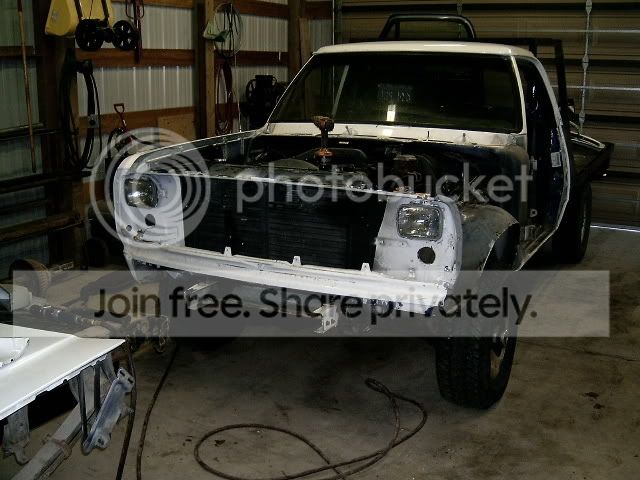

Here is the truck!

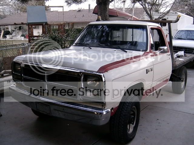

I paid 1201.00 for this truck and of course I have it listed locally for a substantial profit but hope it dosen't sell. Here is the truck.
