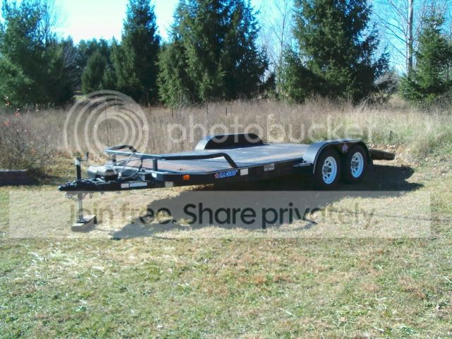

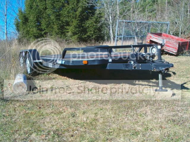

Here is the trailer in reference...The frame is all 2x4 boxed, and the crossmembers are 2x4 C channel @ 16" o.c. front to back. I have hauled more than the 7000gvw, but only 100 mi. or so. I don't want to try that going to Moab next year, so the axle upgrade would be some good insurance. I feel pretty confident in the frame strength. It will also be using an equalizing hitch, and a sway control. It pulls real nice that way.
My 10k is 6" C channel tongue running all the way to axles, with 6" channel perimeter frame, just for reference. I'm not a fan of boxed steel trailer frames, simply because you have no idea what the rust is doing inside the frame (but that's really off topic). I'd be likely to do the same thing you're doing if I hadn't bought a 10k to start with.

I would have too, if I would have looked into the future more back then....7000 seemed like plenty, as its primary purpose was the Vette (3150), but as I said this is only 5 years old, never seen salt, and structurally is in great shape. It appears as though the axles would have the toughest part of this journey if they were left at 3500#. I would feel more comfortable with the 5200#'s with this many miles to travel. And the K5 with trailer would probably only be 7500-8000 total weight. Everything I can, I will put in the truck for this long of a trip. However, finding a good deal on a 10K trailer and selling this one is still a possibililty.
