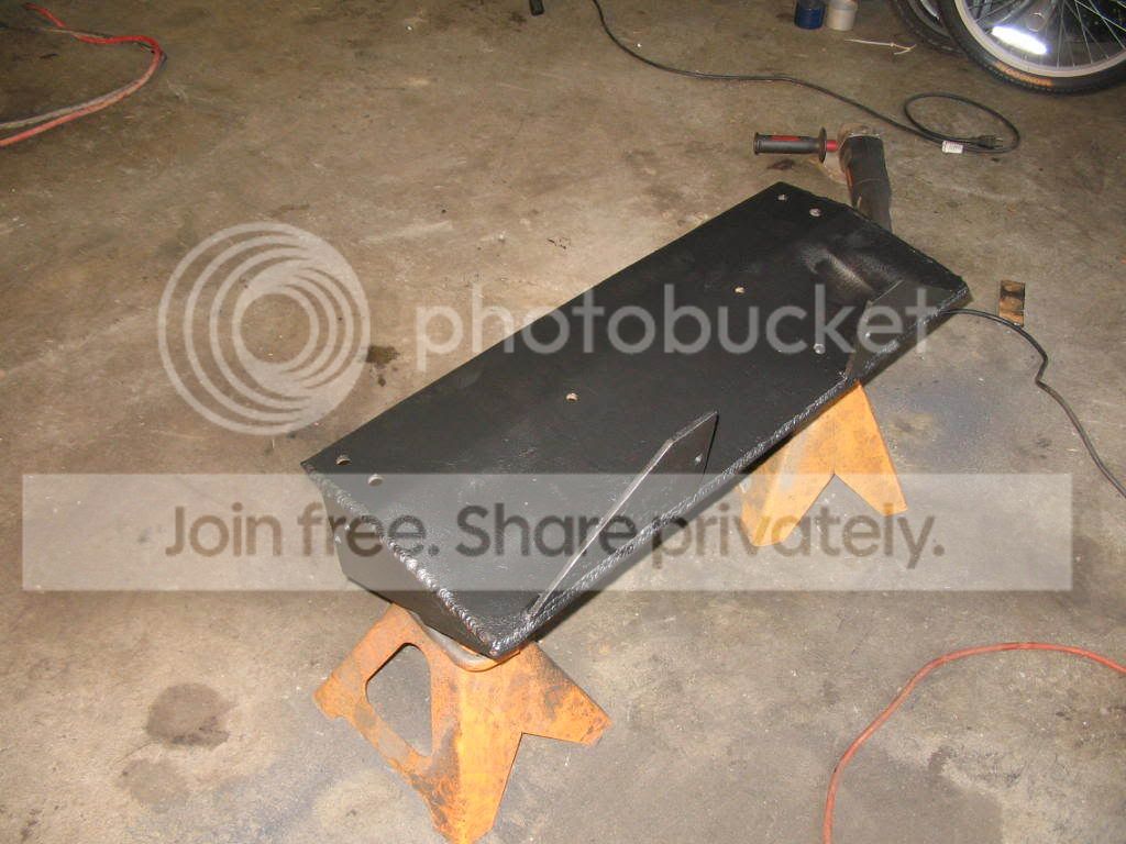

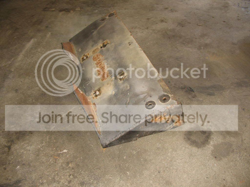

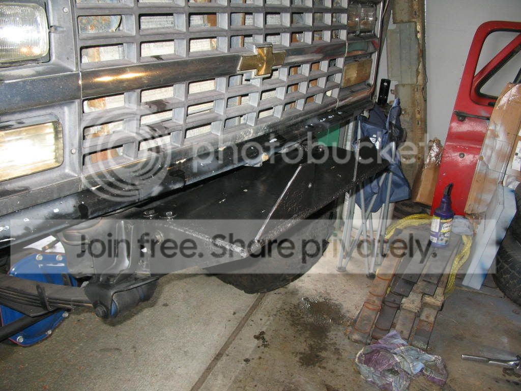

I don't know how your winch mount is made but how about make your own mount bracket. I just made mine into my bumper and came out just perfect for me.
You may be able to get Kert's B52s to fit in the rear position.
Pics of shock mounts?
Here is what I did with mine.
Just trimmed some off each side. It still has 3 1/2" bolts per side holding it on.
