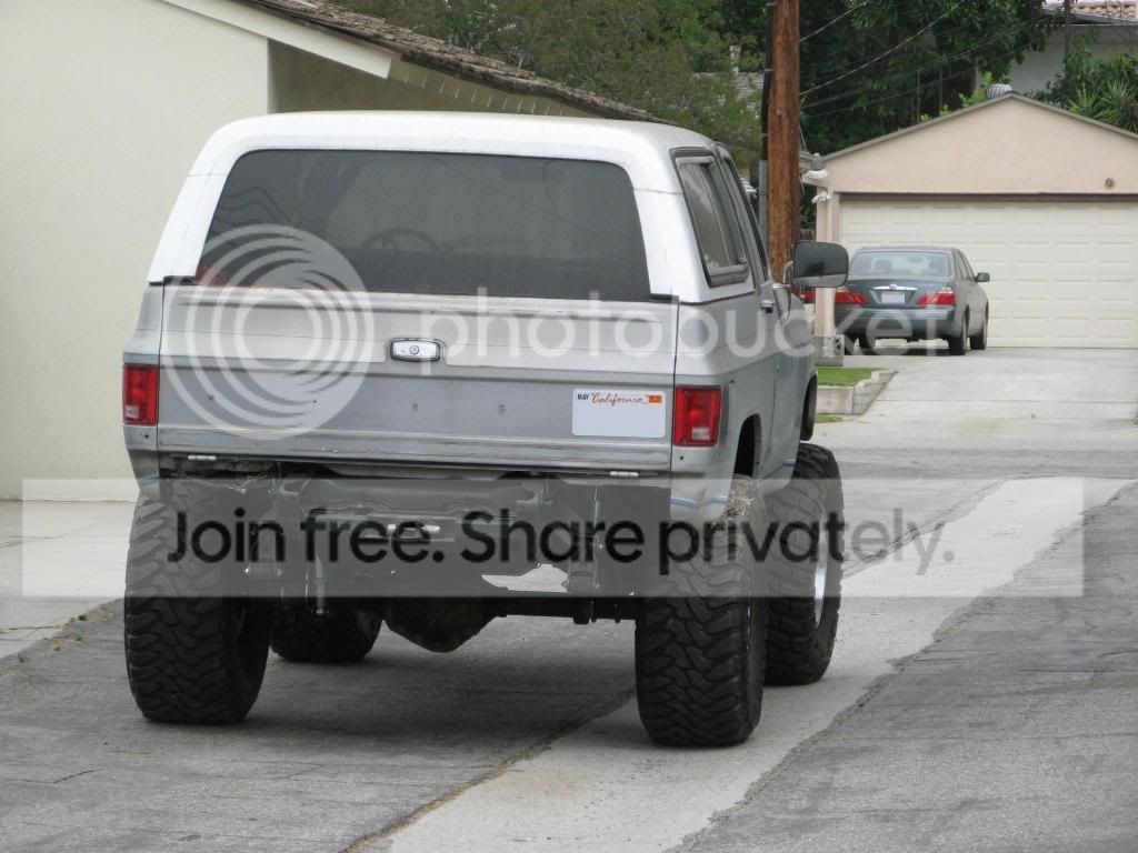

It's good. I have the 4" HD spring pack up front. With the bumper and winch (not pictured) it rides good with Bilstein 5125s. I don't run a swaybar either, but if you don't flex the suspension much, mine as well keep it. (56s out back)
Good looking truck and stance!! what size tires are you running?
