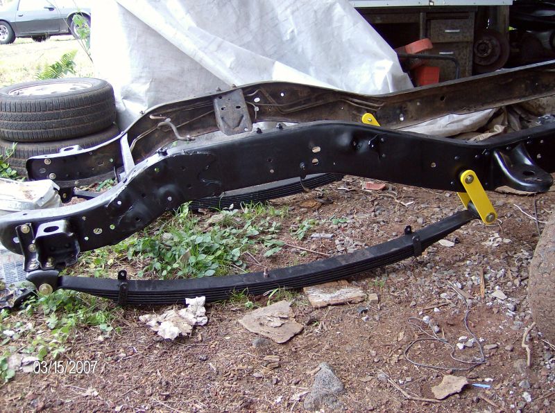

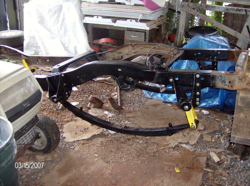

Finally got everything cleaned up and painted, rear brackets all in place (1ton brackets on 1/2 ton frame), shackle sides made... put it together. Looks like the shackle angles will work out just how I wanted. Front is regular 52" mod to the front mount, stock shackle hanger location for the rear mount. Rear is 1ton front mount moved 4" forward and 1" down from stock, rear mount is 1ton front mount + custom support bracket for homebrew shackle flip.
Front
Rear

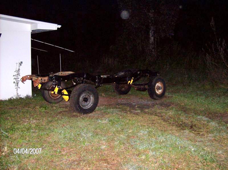

ROLLER!
Rolled it out of the shop space into the yard, just to prove it rolled. No u-bolts holding the axles in yet, but all the weight is on the tires. Also removed 2 more leafs from the rear packs... now they're about as stiff as the old short bus rear springs were.... which worked great.
