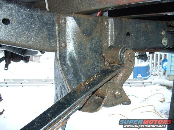

at inspection the guy asked me to park my truck until I fix it..
this is what he saw...
I called superlift and the guy had me measure it...
I am 54" from eye to eye...
he said that is funny... those are 56" leafs on a truck meant to run 52"
so a tad bit of rivet poppin and hole drilling and I have this...
I simply measured every hole back 2" and viola..... 56" upgrade that I didnt even plan!!!!!!
