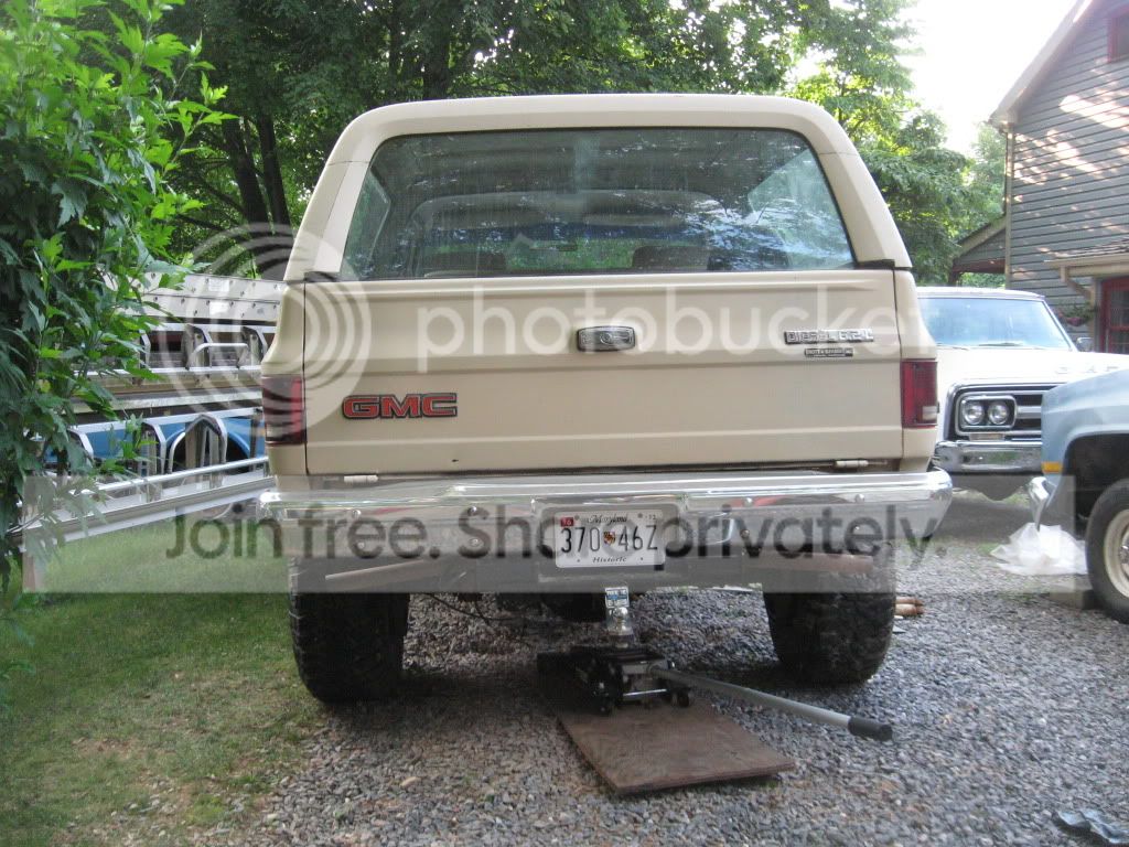

Is there anything I should look out for putting 56s on my '85 Jimmy? I can see I'll need to modify my tow hitch. Are there any problems with the bumper brackets or fuel tank mounting? It looks like it will be ok,just wondering if I'm over looking anything here.

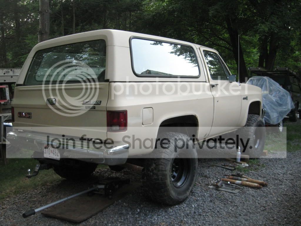

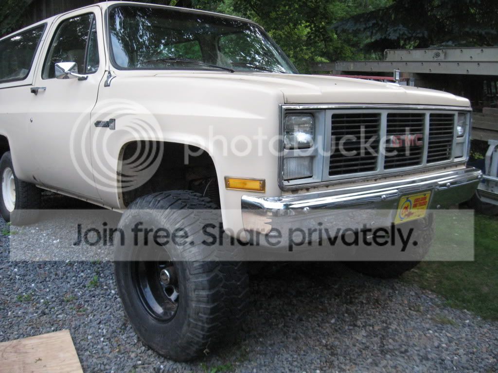

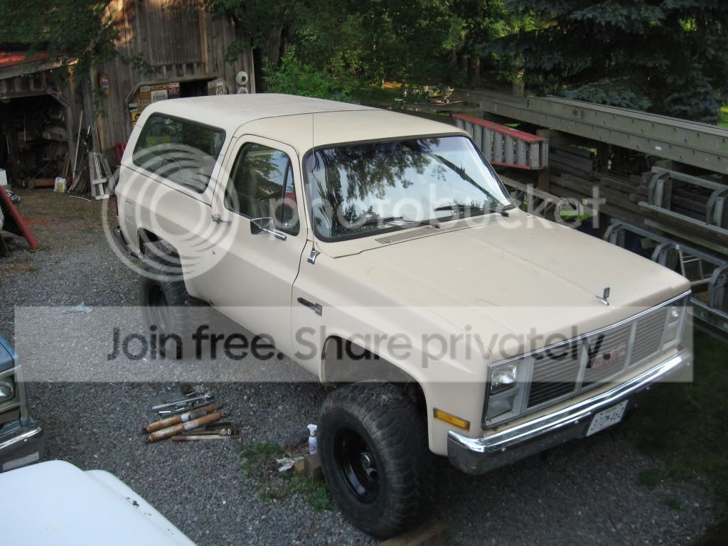

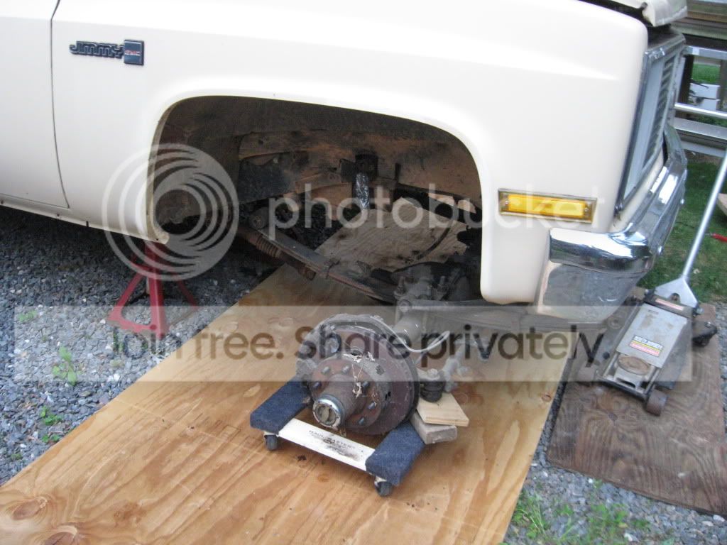

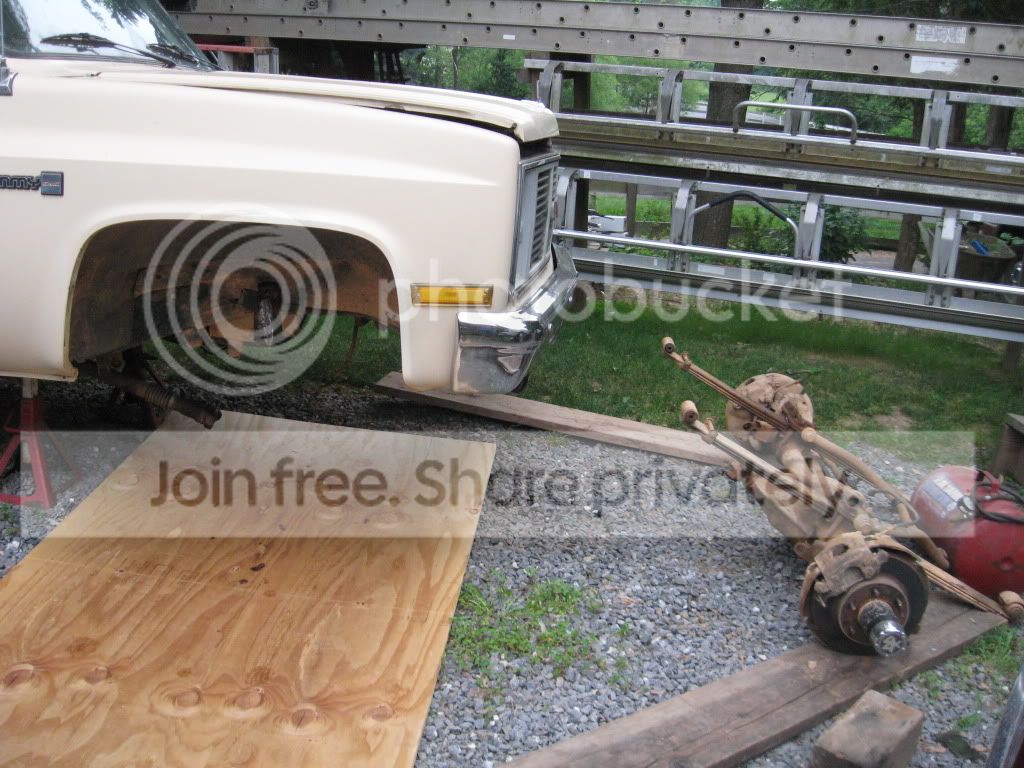

What I'm doing is swapping the suspension and axles from my retired '91 Suburban over to my '85 Jimmy replacement. Front is done and I'm pulling the rear stuff this week. Everybody likes pictures,so...
