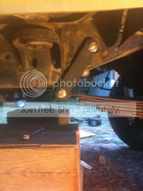

just put a set of 56"s under my cucv, i used b52s in the furthest forward option, as well as 7.25" shackles, and was wondering if anybody else has had the same issue i do, i only have about 1/8" clearance between the spring eye and the frame. After looking at a ton of pictures on here i have determined that my frame is taller in that area than a half ton truck or blazer. Im considering notching the area where the spring contacts to give it room for some uptravel, is that a reasonable idea? i'll post a pic once i get past the 5 post rule

Are you talking about the front suspension? I have 57s on a 1985 K30 frame with a little longer shackles and no clearance problems but all my stuff is homemade. Is your shackle angle wrong?

I would say your options are:
1. move the front spring hanger forward
2. move the shackle mount back and down (modify the cab mount)
3. cut and plate the frame for more clearance.
It depends somewhat on your steering and fender clearance.
thats just a 1 ton frame thing. flex it out and flatten that spring, see if you even get close to the frame. your springs look pretty flat now, might not be a real issue.
cant move the hanger forward anymore, in the furthest most forward position on the b52, don't really want to move the shackle and modify the body mount so it looks like i'm going to cut and plate the frame, might decide to move the shackle got to look at it some more
there's less than 1/8" between the frame and spring eye so i definitely have to do something

I can not guarantee 100%, but I am 99% sure you will not have a problem, your springs are almost flat and you will not gain any more length when they do get flat so your springs should not touch the frame even with just a 1/8" gap.
To know for sure put some playdo on the frame and jump up and down on the bumper trying to cycle the springs and see if the playdo is indented or not.
D onot touch the frame if you don't really need to.
