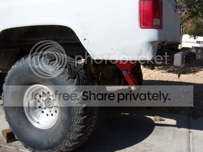

so i want to do 56s in the front and rear. i did 64s in the rear last time and i dont want to move the front (of the rear) hanger forward. if i do 56's i only have to move one hanger correct? same with the front right? move the front hanger up and leave the rear put correct? also i found this pic of DIY4x and i dont think the angle is correct am i wrong? it looks like he moved it forward not back?
The angle is very bad if that is static height.

That pic looks to have the Flips in position for 56's but probably 52" springs. If he swapped them side to side the angles would be correct.

The captions in the tutorial on the site say about how the owner plans to switch those 52in springs to 56s so he put them on flipped before he got the 56s.
The shackle angle comes out better with 56s and flipped than it does with 52 IMO.

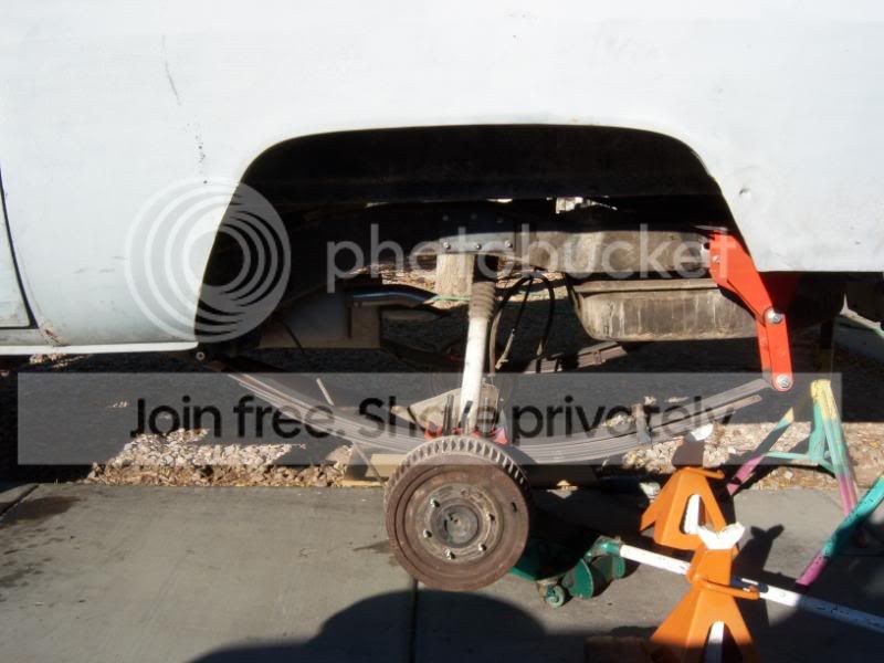

Here is my shackle angle:
That is with 56" springs long side backwards (4 leafs + overload), DIY4X flip swapped side to side and 6" shackles. With a Easy Inch, it was just about 4" of lift. After this pic I flipped the overload and moved the axle back 1.5" - the shackle angle is a little bigger now and the truck is a little lower in back.
