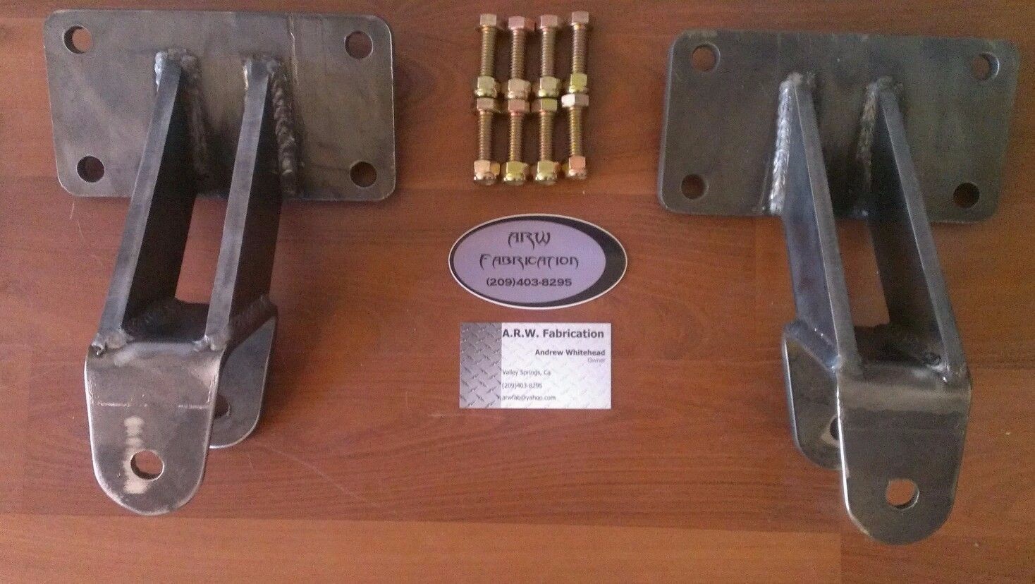

So does ARW fabrication:
http://www.arwfab.com/product/1973-1987-chevy-k10-4-lift-shackle-flip-kit/
About $150 shipped.

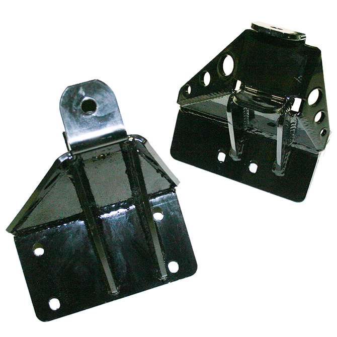

RuffStuff also has one:
http://www.ruffstuffspecialties.com/catalog/UNFLIP.html
this one doesn't have a Chevy hole pattern, so you probably have to drill the frame.
