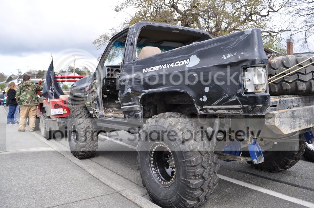

Yes. You will need a longer shackle to make it work. With my stock shackles it was just like you describe. I run the 7" shackles now, but 6" would give a little better angle IMO.
Stock
Can't find a picture from the side right now, but DIY 7" shackles
