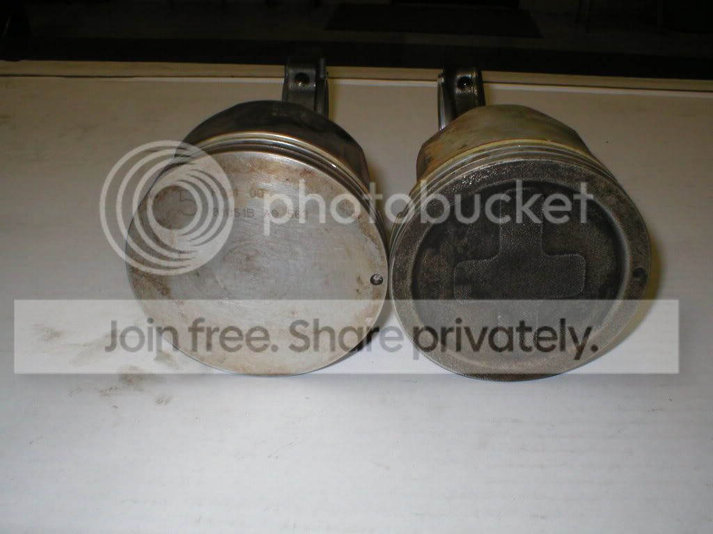

I thought the heads were all the same, with the exception of '99/'00 which are all cast iron. when they went to the aluminum head on 6.0's in '01 it is a 317 casting. they have stayed 317 castings from 01 all the way up to a gen3 '06. unless you are talking about a gen 4 aluminum block 6.0L, i'm pretty sure that LQ9's have flat top pistons making ~10:1 whereas the LQ4's have a 6.7cc dish piston with ~9.4:1.
LQ9 on left, LQ4 on right.
