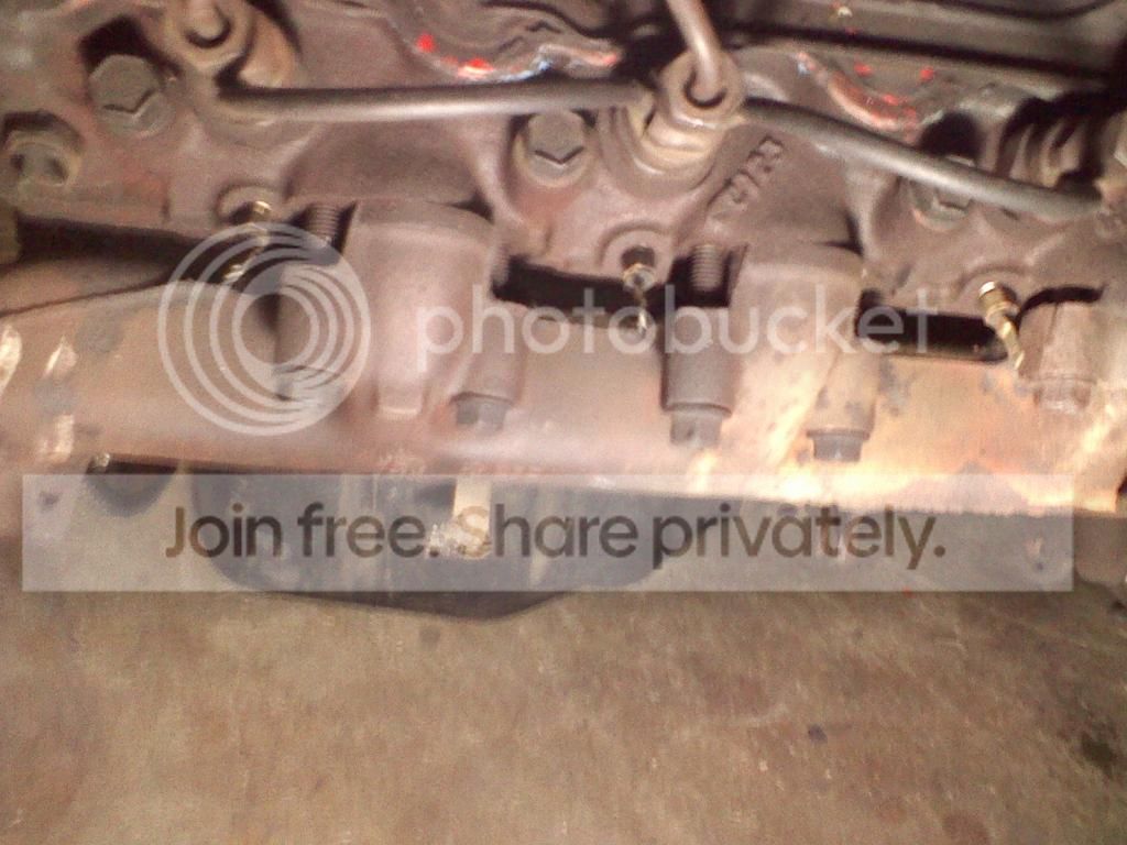

Are you eluding that that header will fit on the engine pictured with the cast manifolds? Because it looks to me like the mounting flange bolt arrangement is different.
Did 6.5s come with those headers and a different mounting flange bolt arrangement? Or is this going to be some made custom flange affair...
EDIT- Nevermind.. I'm retarded. Thought I remembered that the manifold bolts on my 6.2 were all in a straight line, and not staggered up and down. It also looks that way in your first pic, so that didn't help.

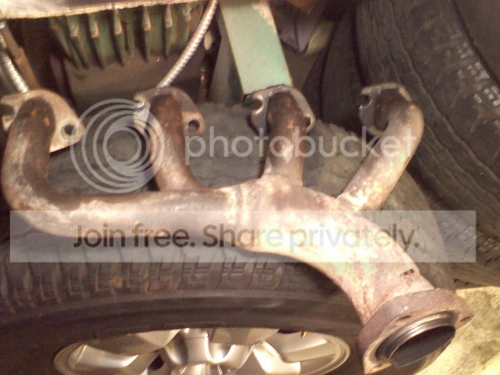

Living in Southern California, I don't have any rust worries. When I said headers, I meant the second picture, they came on the '86 engine I bought from GL.
Sorry about the angle on the cast manifold picture, it was late last night and I came home to the engine on the ground, a couple buddies came over and pulled it while I was at a BBQ.
The picture of the header looks like the driver's side from a Hummer...the question is what does the passenger side header look like? There are fitment issues when trying to use stock Hummer headers in this body style of truck.

Stans or someone makes actual headers. Just go stock driver and a pass banks manifold with a hx35.

Are the "headers" stainless? I know I saw some stainless headers in the GM parts manual, but they were for a small block. Unaware they made them for the 6.2L.
They came with the engine I purchased from GL out of a Hummer. So, I have no idea, but from the rust on the, I doubt it.
I put headers on my suburban years ago. My seat-o-the pants impression was I didn't think headers made much difference at all at low rpm which is where diesels live. Buut, if that came with it and it looks good I'd run it. Just by looking at it, it seems impossible to flow worse than a manifold. Isn't the turbo in the valley on the hummers?
From my understanding most military Hummers were not turbo'd, especially the pre "up armored" versions.
He verified above that the header is off a Hummer....again, look at the passenger side and you will see that the outlet of the header points straight back and will be against the firewall of the truck.
