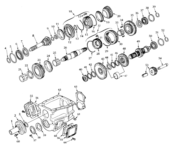

Well the SM465 is a rock crusher trans so that means it has straight cut gears so you always here at the very least a definative whirr from it. It is easiest to hear it at idle, at least for me.
The engine I have in my truck now is 305 from an auto Firebird and all that was done was swap the flywheel from the junk 350 to the 305. But I would be sceptical that you can use a gas fly wheel with a diesel. I think the fly wheel is your problem.
Only first and reverse are straight cut, the rest are helical...
Rene
Rene
Wait, I thought they were all straight cut? :dunno:
Not the greatest view, but you can see it here.
Rene
Better view...
And, it looks like it's just reverse that is straight cut...
Rene
