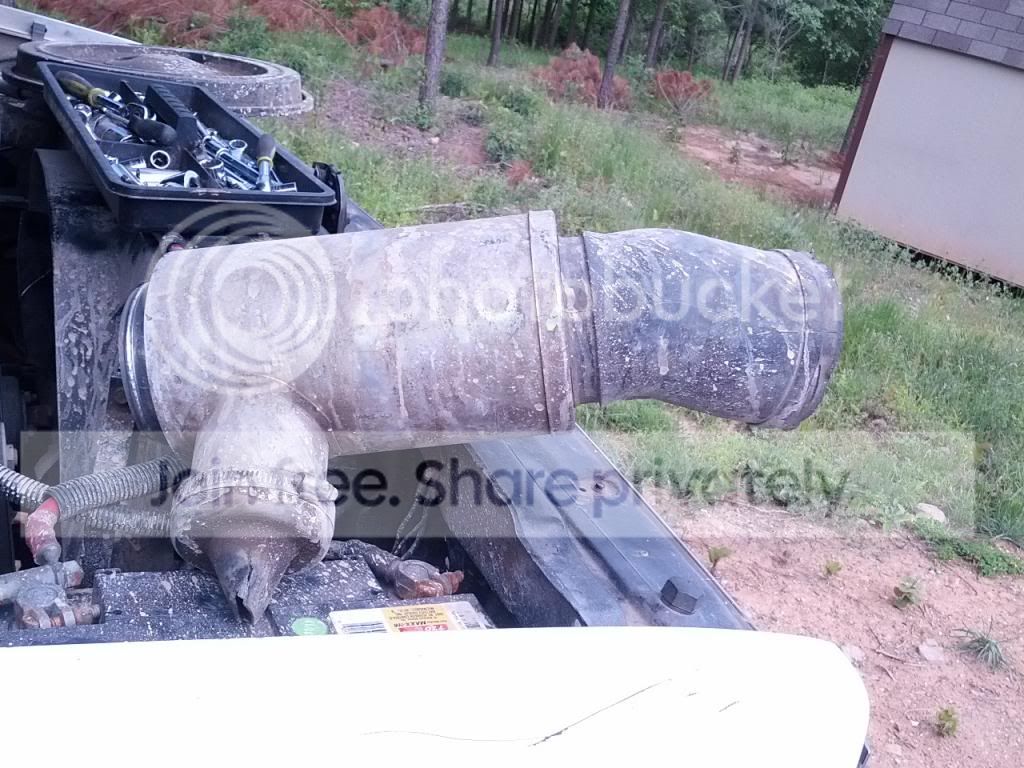

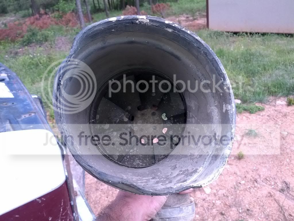

Anyone still have one of these? Looks like those silly infomercial things. I wondered if it was aftermarket cause it said 'made in canada' on it, but googled some pics and saw a bunch.
Think it's fine, or junk? Restricting airflow? Take it off and just run a tube to the grill? I dunno.
Before I took it off today I thought it was hollow. There's a dump valve on the side so I thought it was just there to catch crap. I understand the reasoning behind the turbine thing. But in my mind I just see a big restriction. Then again I'm sure the engineers of the 6.x series know a bit more than I do :D

I dunno what that is but throw it away and just run a tube to the core support.
Whatever it is it's not supposed to be there. GM didn't put it there.
Neither of my two 6.2's had that thing on them,my '85 Suburban does have a similar looking thing between the duct pipe to the grille opening,and air cleaner housing though...
I think its some kind of silencer to reduce intake noise...my pickup just has the air cleaner housing,someone deleted the wrinkled plastic duct I guess...it is noticeable noisier than the Suburban under acceleration,but I rather enjoy the noise...:D..I've seen quite a few other 6.2's and dont recall seeing a thing like that one them,maybe that was a military only thing that was part of a snorkel setup or something...:dunno:
CUCV's didn't a have snorkle at all.
Didn't even have the knock outs in the core support removed.
I dunno what it is. But I did see the exact same thing in some pictures I googled looking for it.
Either way I think here in the next few days I'ma grab a bit of ducting and go straight from the filter box to grill. Just gotta find something rigid enough so it doesn't sag in the middle. Don't wanna use dryer alum ducting. Maybe some kinda plastic tubing stuff like in the RV section.
Junkyard, find something that works. Think I used one off a 90's square body Dakota with a V8.

That tubing is somewhat of a silencer . I have 2 0f those setups , they are off 86 C30 trucks with the J code 6.2 . The other ones are the plastic oval type that mounts on a bracket on the right side of the engine . Mine have brackets that bolt to the inner fender and support the aluminum housing . The rubber piece is called an evacuator . See them on diesel air filter housing . I do have GM parts books and found them there also . I don't have full membership , that's why the PM .
It's an air intake silencer.....basically a muffler for the air intake to reduce noise. My '90 had a very similar looking thing on the air intake years ago.
