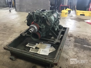

If all you need is the motor at $3000… I would rather use that $3000 and buy 3 online auction 6.5 diesel Optimizer takeouts on Govplanet.com
This would give you a much better block and you would have 2 left over blocks you could easily clean up and sell for $2000 each not including any parts to the block.
I second the GEP 6500 Optimizer suggestion. No, the center mount turbo won’t fit in a square body easily. But those engines can take a side mount turbo just fine.
Where is anyone finding optimizer engines for $1000!?
They pop up on govplanet.com from time to time. You could get them less then $1000 sometimes but they may need to be rebuilt because they sit outside on pallets exposed to the weather causing the piston rings to rust in the cylinders.
Yes, but don't forget buyers fee's, crating charges loading ,& shipping fees State Taxes .... online buying has extra surprises .
In an unseen engine. Scary thought

Some Optimizers on auction just popped up. Would have to swap heads if you wanted a side mount turbo. Even if you just bought one for only the block, it would be worth bidding at least $1500 I think… You could use your current 6.5 parts to make one badass Optimizer for cheap.
Out of all of these motors, I think I would rather shoot for this 6.2 that looks brand new, put 18:1 pistons, girdle, main studs, head studs, Fluidamper and turbo it.
