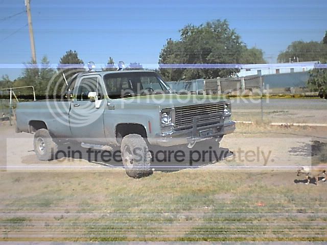

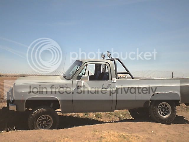

here is a pic of the before
and well thats it

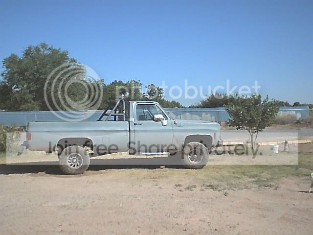

That home made pic had me at first glance. hahaha. I was like Jeez, the upper half is so clean.... how'd he do that???

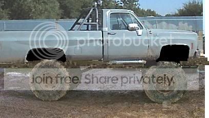

well this weekend i got the brake lines on , the e-brake braket on, and grined down the front shaft a bit. i beat the crap out of it once i checked everything!!! at first the front drive shaft didnt reach and today i checked it and i had a butt load of clearance!!!! so...... i decided to get it caked in mud, my back yard is still a pond, and well im really happy with the results.
