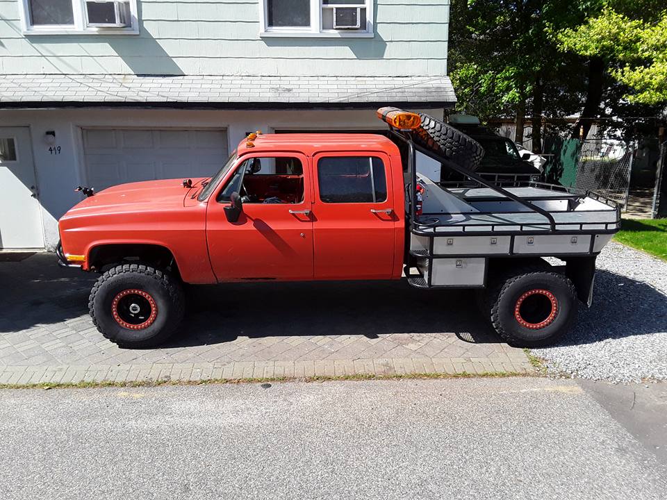

On my'72 K5 I have a 4" soft ride in front with a shackle flip in the back.
I had 39.5" boggers on 16.5x12"welds with no rubbing, but now on a new set of 37" pitbulls on 17"beadlocks.
But it took some major surgery to make it happen...
I put it in the complete vehicle section here on ck5. Here's some pics, more in the listing. Take a look...
4” front and rear springs 1” body lift. Larger spring perches that move the rear axle back 1” on the rear axle and lifts about 1/2” with 14 bolt SF rear (1/2”?) on 35x12.50r15 BFG A/T. When wheel it It doesn’t rub. For wheeling I would love 37” for ground clearance when aired down but know it would start rubbing. Mine sees mainly street, backroads and hunting. If I crawled it more I would go with 37” but would have to go higher. Not worth the money in tires and wheels when you make the jump to 37”.
