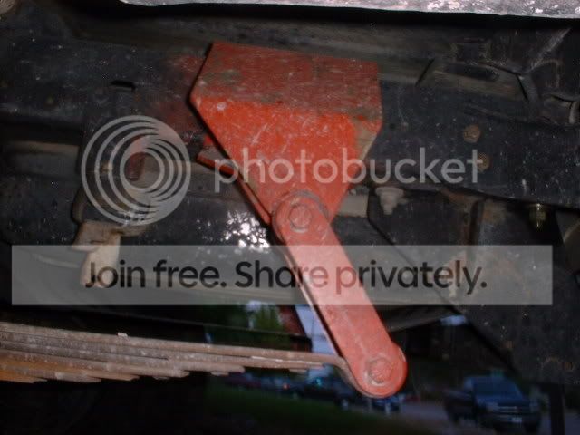

I run 6" of lift with the DIY shackle flip(4" lift), a DIY 6" shackle(1" lift), and a zero rate(1" lift). I have 56" rear springs and this set up is very flexy, and im still using the factory holes for the shackle flip. I have a 55* shackle angle also. www.diy4x.com
I would recommend this setup to anyone.

What do you have for the front? I was going to do something similar with the ORD shackle flip and zero rates but if the DIY uses the factry holes that seems way easier for instalation. Ddid you still have to remove the gas tank to put in the bolts?

If you mean the front mount for the rear springs, I still have the factory spring mount. The DIY and ORD kit both will work in the factory holes.(read more below pic)
Notice how the bushing on the mount is towards the bumper? if i ran 52" rear springs, the bushing would be toward the axle. To do this you take the mount, and put it on the opposite frame rail to run 56" rear springs. Im 75% sure the ORD unit will do this, and im 100% sure the DIY kit will work.
I personally like the DIY kit as it has 2 bolts that go under the frame rail, and also uses straight shackles, which are easier to work with and make your own.
And yes, you will have to drop the tank no matter what.

Nice setup Citizen:waytogo:, did you run the shackleflip backwards (reverse sides)?
Correct

EXCELLENT REFERENCE PIC :bow: :bow: :bow: :bow: !!

Correct also. Suprisingly tho, with my factory 10bolt spring perches, my pinion angle was pointed right at my tcase. I know some say this isnt great, but i had no vibes what-so-ever. Also its nothing a shim cant fix. I put new perches on my 14b so its changed up alil.
With a truck or suburban, you may need to shim it down, instead of upwards.
