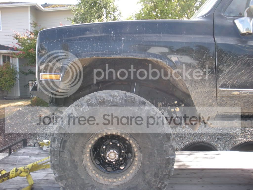

I lot! This is wi th a few inches cut. I need to cut more. This happened on 38s, which is what's on there now.

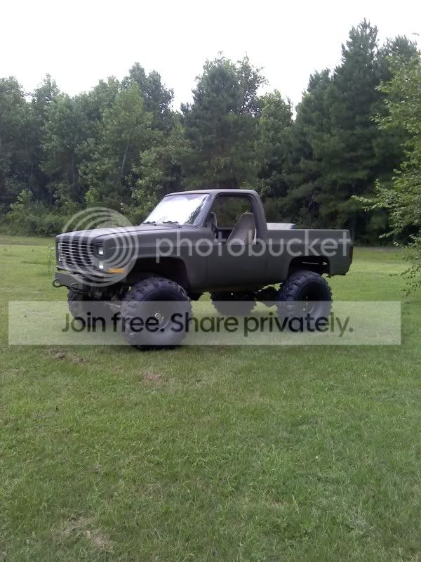

This is 6 inches and 40s (4" susp. and 2" body). A good bit of trimming is needed but you can still make it look decent if you take your time.
