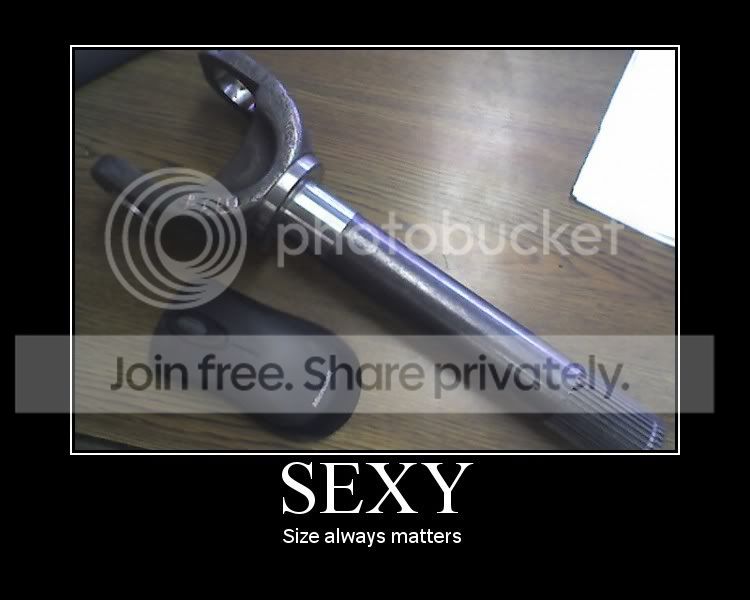

It might just be the Yukons, they have really thick ears. I just know that when I put mine togeather they would bind well short of what my steering angle is. Call Buddy at foothills and price a full set, you might be pretty suprised at the price. Here is what the chromo Yukon stub shaft looks like.
You just ruined my night. Guess what parts I have sitting 10 feet from me right now. I know I can't get any other brand for anywhere nearwhat I paid for these. And yes I'm running spicer inners and spicer U joints.
Oh well thanks for the caution. I'll have a look before I return them.
