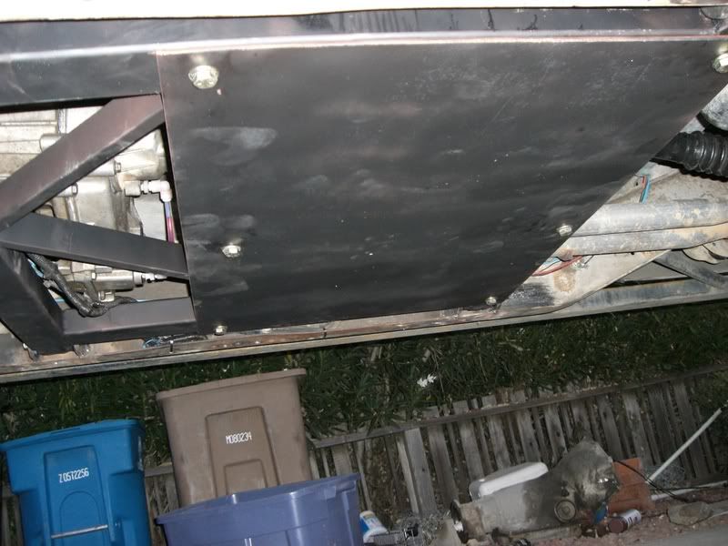

Dropped the crossmember, drilled, tapped, painted it and cut up the sheet steel for 2/3rd's of the crossmember. Need more cutting discs to finish cutting it up to make the last peice. Whatever makeup this steel is it is a lot tougher to drill and cut with abrasives than HREW tube, it absolutely tore through cutting wheels and only cut with a very sharp bit, lots of pressure and cutting oil.
