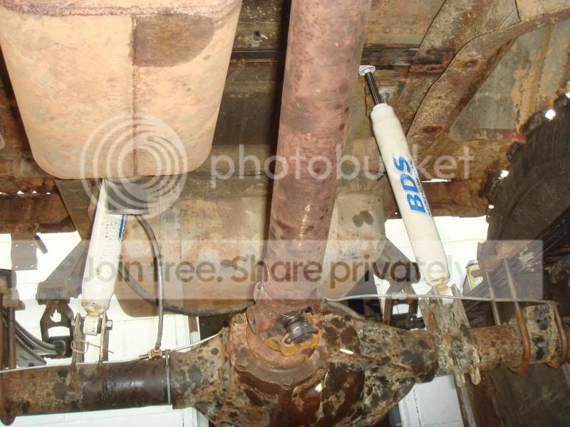

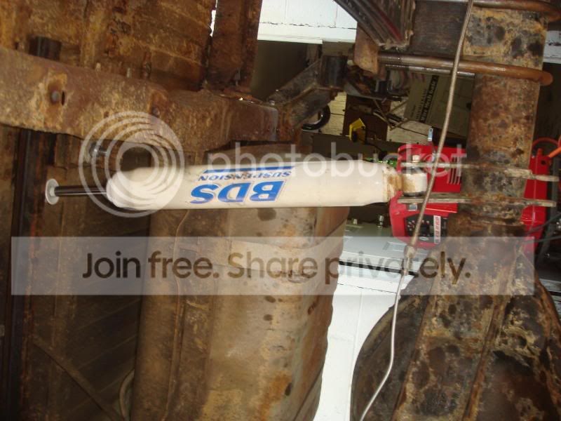

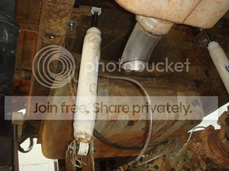

I got my shocks inboarded and they are mounted on the frontside of the axle. If they were on the back they would interfer with the gas tank

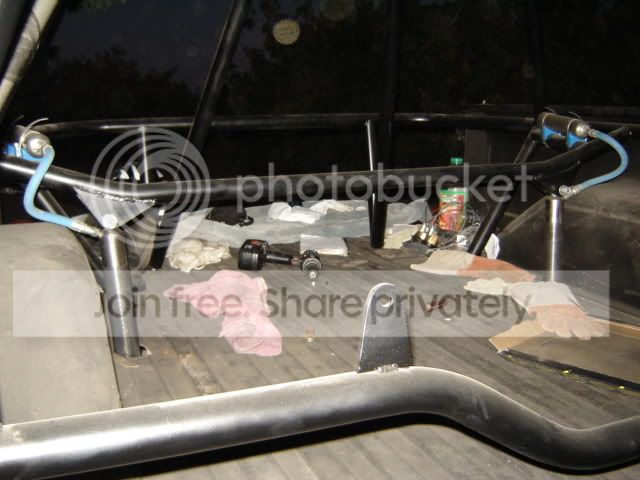

here was my 64 inch shock setup 3 inches of up travel and about 9 inches of droop

If you don't want to angle the shocks, you will have to cut the body. If you don't want to cut the body, you will have to angle the shocks (which reduces their effectiveness).

why are you only running 3 inches of up travel will it not flex up any more or will it hit the tank. On my sub swap i pulled 8.5 inches of droop or down travel and im guessing about the same up travel im going into the floor with the hoop????
did you mesure the up travel or just set the shocks up for the most droop or down travel. how much reverse arc did you get out of you're springs.
i didnt really set anything up...that was a day before a wheeling trip i just put that together and it worked out with 9 inches of droop...to anwwser your other question
