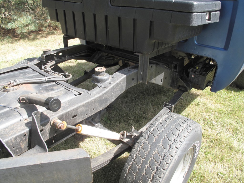

79 K5 Blazer frame, 87 R10 cab, 2004ish new 2500HD springs, nothing in factory location except gas tank crossmembers:
Quite the shock angle you have going there. Effective ratio has to be about nothing. Not trying to be a jerk, just commenting.
