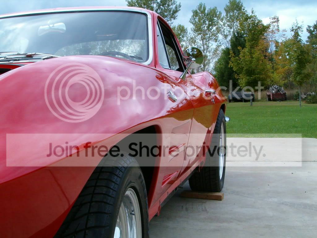

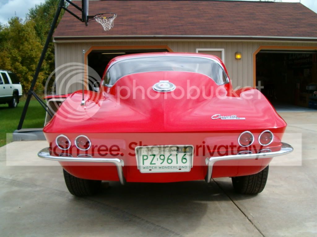

first car show (in 2004) after 15 year rebuild:
attachment.php
Car was a body off restification that took 15+ years due to 2 divorces, and moving 4 times. Mostly stock components used, other additions to my satisfaction. Car was completely disassembled for rebuild. Literally every nut and bolt came off the car. The body was a shell when it was stripped. Then repaired (all 4 fenders replaced, and many little cracks V'd out and glassed back in to repair). 3 color coats of Torch Red/ 2 clear. Frame and all running gear chemically stripped, and painted. Interior of frame Ziebart coated for protection from rust. I reused the original seat covers, dash skins, headliner (repainted) and door panels, and interior trim. Most interior chrome replaced, and all exterior chrome replaced.

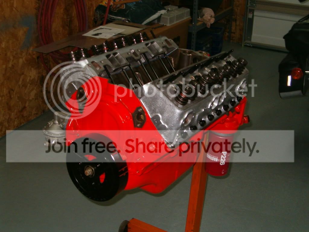

Short block completed:

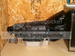

The rebuilt T400: full reverse pattern manual valve body, and deep aluminum pan from Coan.

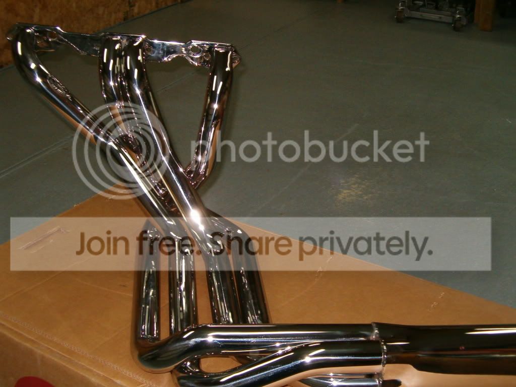

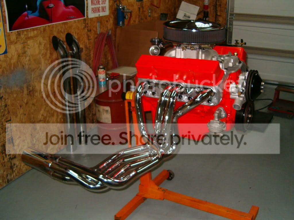

And a new set of Hooker Super Comp stainless sidemounts:

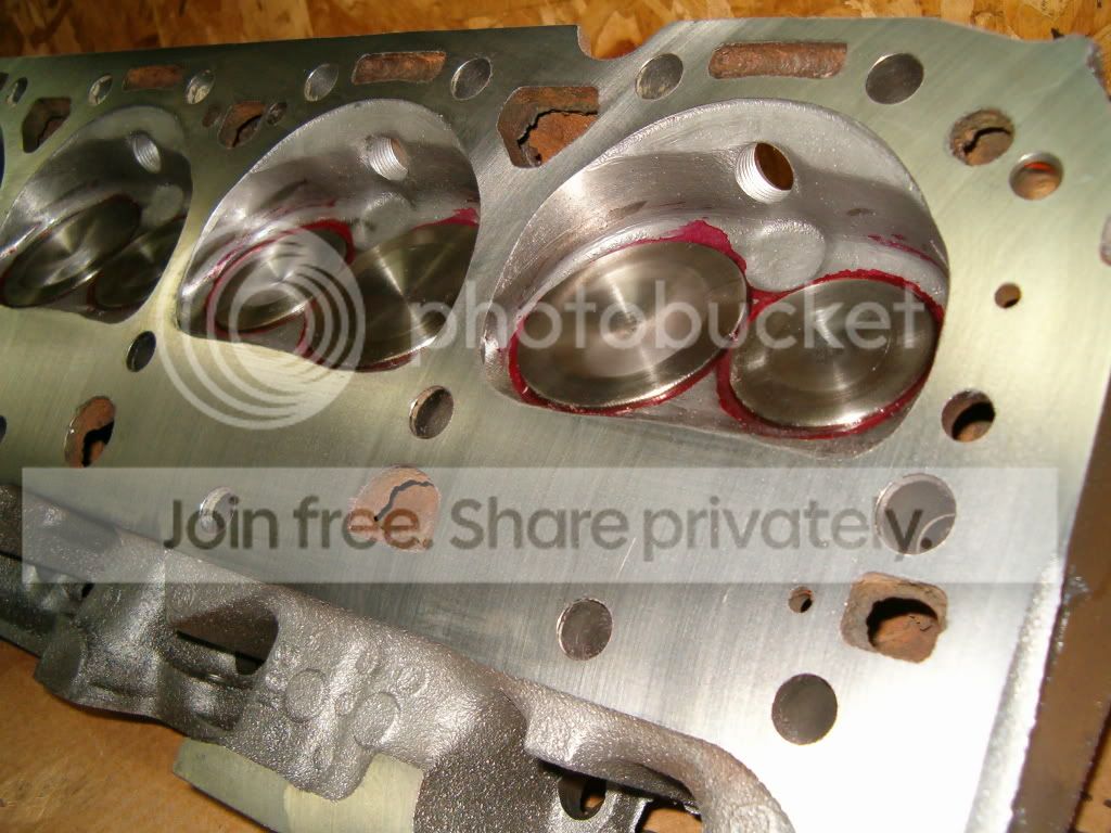

Heads:
double hump 2.02's, Stainless valves, competition valve job, competition port work.

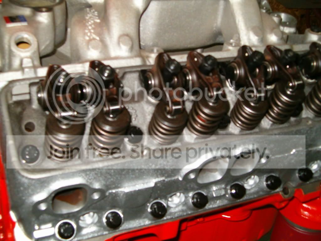

OK, the car is still sleeping in the garage, but I have been tinkering with this:
I got the valvetrain put together finally. I had to open the holes up for the pushrod guideplates more, to get the rocker tips to align with the valve tips better. Now the roller tip is fully covering the valve tip.

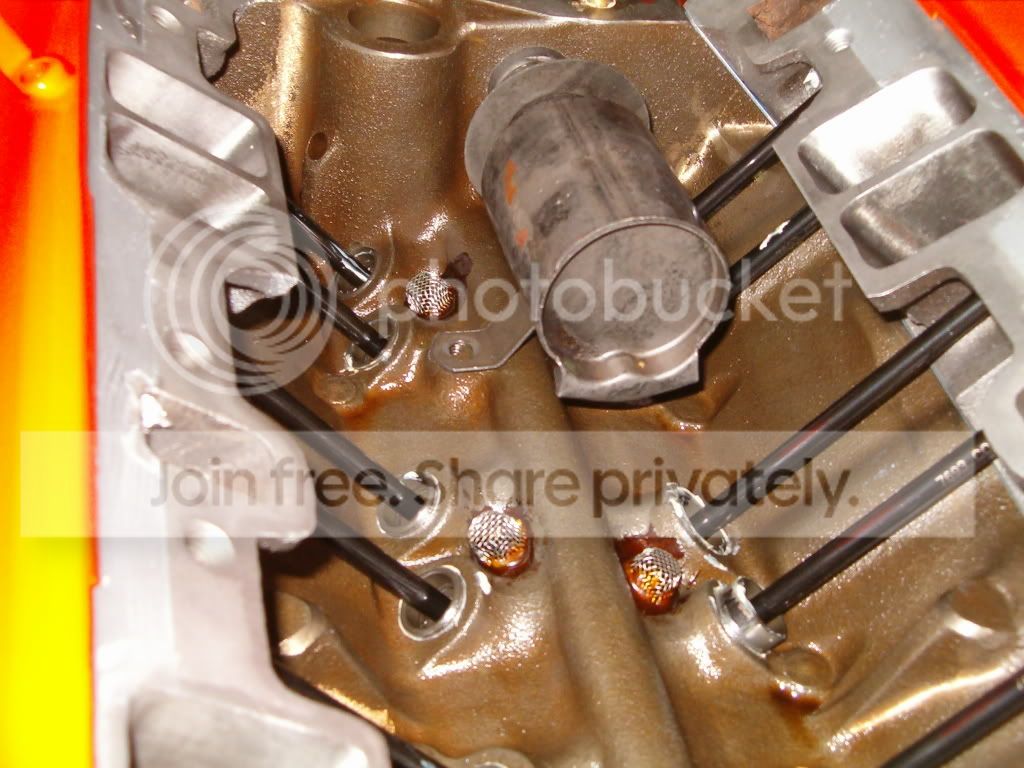

Whats the deal with that oil pan? Ive never seen one like that before.

The oil pan, is for the solid lifter engines back then. Its a factory 6 qt. with a oil baffling system in it, with the windage tray on the bottom of the main studs. I should have taken a pic of it huh?
I got the valve train straightened out finally. Now to the mods on the manifold, breather system etc.

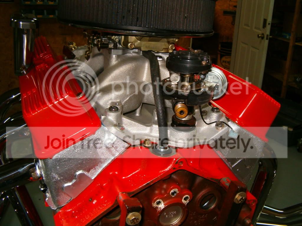

modified valley baffle to work with the RPM Airgap manifold.
Before: the can was too long. It would hit the bottom of the manifold.
shortened it up, and now it clears the bottom of the manifold, and pretty much serves the same function.
Intake on, valve covers, breather and PCV system worked out....this things finally ready to put back in the car....just in time for winter storage....

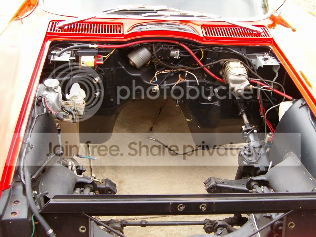

I'm working out the logistics and placement of an electric fan right now. I have to make some mounting flanges to bolt it to the radiator support.
But this is what it looks like right now.
