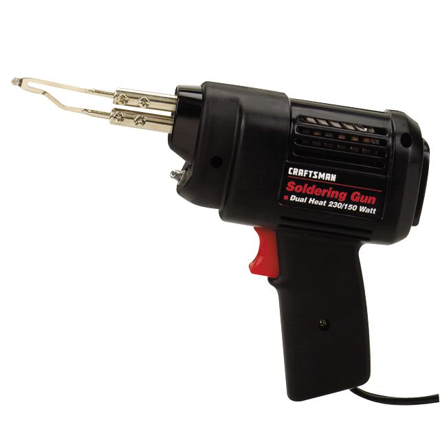

a good weller soldering iron and a solder sucker.
That is what I used as well. You could probably get by without a solder sucker, but it sure makes things easier.
You'll need a soldering iron like this:
Not like this (way to big).
