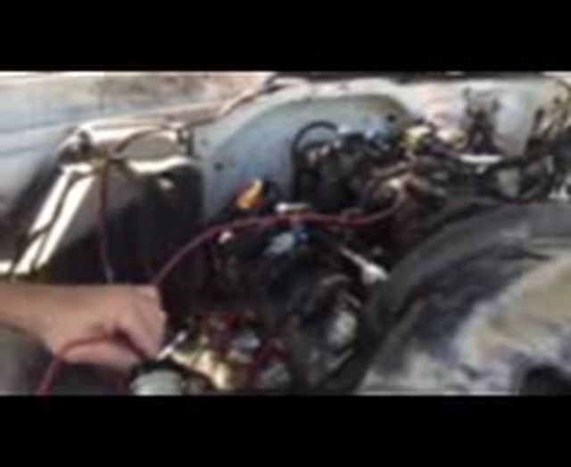

Need to replace radiator, (had a hole in it not aware of) radiatorleak.jpg, front brake and transmission hoses, exhaust, still looking to see which muffler I should go with, don't like the loud flowmaster 40 series and not sure of 50, tires those are rotted, and little crap that keeps popping up. Also need to figure out how to connect the 4wd.
Almost done I can see the light.
Are you still running a MAF? If that's it next to the filter, I'd try to move it away, like between the filter and your 90* at the TB. Really should have straight/no turbulent air going though it
Thank You!
