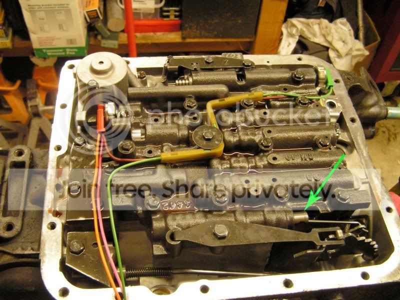

Just drop the pan and look at the parking pawl and linkage. I bet the problem will be visible and there is little risk of messing up your transmission. There is no need to touch the valve body. Don't you need to change the fluid and filter anyway? This diagnosis will be no more involved than that.
When you drop the pan you'll see the shift linkage coming in from one side. The park link is the long rod with a spring on it (at the bottom of the photo below. Ignore the green arrow, it's pointing to the manual valve linkage). Make sure all of that is attached probably and not bent up or rubbing on on something. The end of the rod is like a conical pin that pushes on the parking pawl. Look at the teeth on there and make sure nothing is messed up. Can you take pictures for us?

Here's a picture of the actual pawl - the screwdriver is prying on it:
Dude, that's awesome! Thank you! I had no clue what a parking pawl was or where it was located. Like I've said, the internals of a trans are all PFM to me. This weekend is a 4 day (being a govt employee has its perks) and I will def drop the pan and see what is going on with the linkage, and fresh fluid/filter couldn't hurt. I will post pics if I can remember to take some.

The rod that goes from the rooster comb to the parking pawl has a swedged end where it goes into the pawl which holds the bullet shaped part against the spring above it. The swedge can deteriorate over time allowing the bullet end to slide too far down and contantly contact the pawl. You can remove the rod, push the bullet back into place and put a small bead of weld at the end or just replace the rod all together. If that part is ok, there is a spring in the case that holds the pawl back off the ring gear, if that spring has broken it will require pawl and pin removal, not too easy to do even on the bench. I hope it is the former and not the latter.
