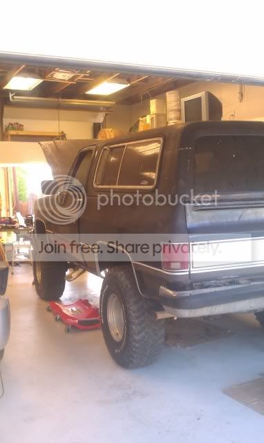

The first pic shows the truck. 1987 K5, 4" lift, 35 BFG MT's, stock gears.

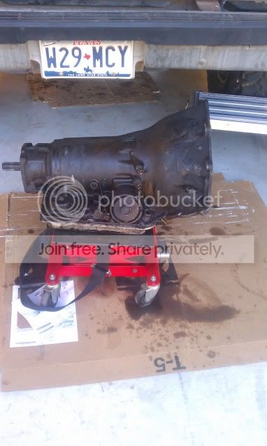

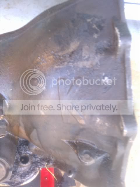

Tranny pics

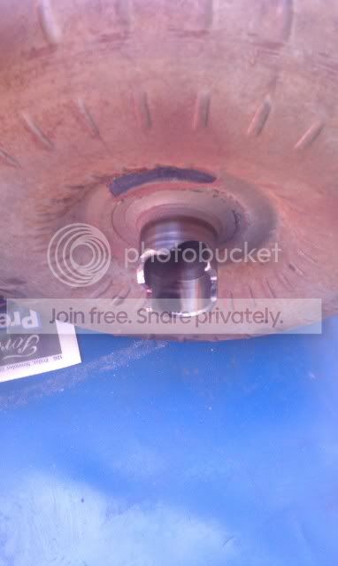

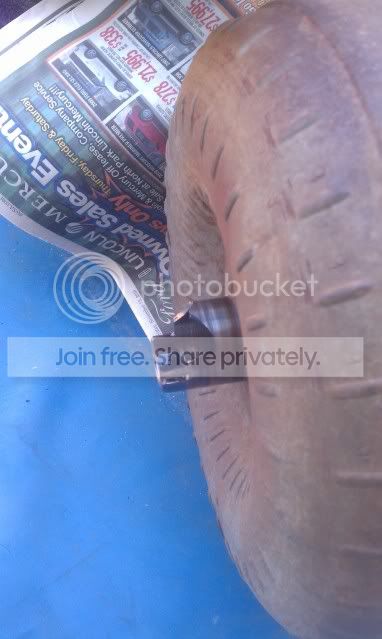

What caused the noise: broken torque converter, the rest was wedged in the front pump.
Tranny pics
