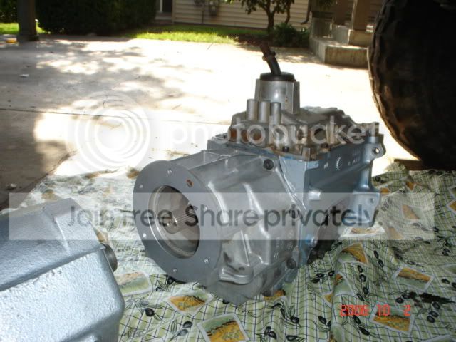

here is a good pic of the back of the NV4500. You can see the generic GM 6 hole pattern and the 32 spline output.
Go check your current T-case to adaptor and you'll see the same 6 hole pattern. The only small issue is the pattern is not symmetrical, and the NV4500 was never in a truck with a passenger side drop T-case. The 6 hole pattern on the NV4500 is mirrored to what you have. It will require slightly ovalling one hole...
