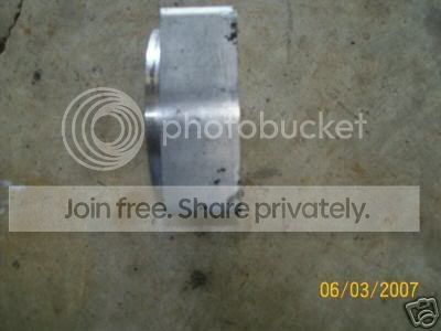

for all you guys wondering how you do it heres a pic of the spacer i used for mine get it from www.automatickings.com 60$ US for the spacer you will also need the 27 spline th350 adapter as well
heres a couple pics of it
