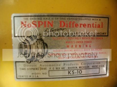

Rear axle is most likely the Eaton H052, but there is a very small chance it could be a FF D60. If the glove box option sticker is intact, look for any RPO codes that start with a G8 and then another number. I forget what their respective numbers are, but if it has the Eaton axle, it could have a factory Detroit locker (will be called a No-Spin on the sticker, there will also be another sticker for this somewhere inside the truck, like on the roof or behind the seat). If it has the D60 it could have a power lock posi, which would also be indicated on the sticker.

EDIT: here is the sticker that was originally put inside the cab at the factory if the Detroit Locker was installed. I have seen 3 of them, 2 on the roof of the cab between the visors, and one behind the seat and next to the gas tank.
