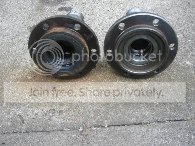

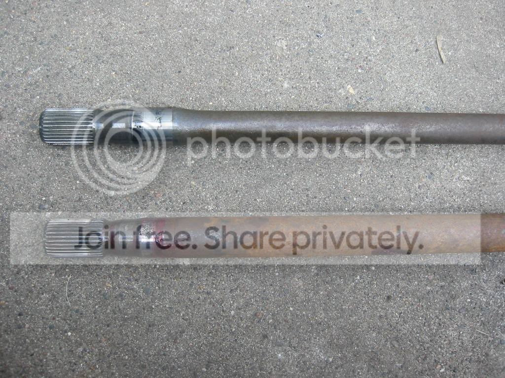

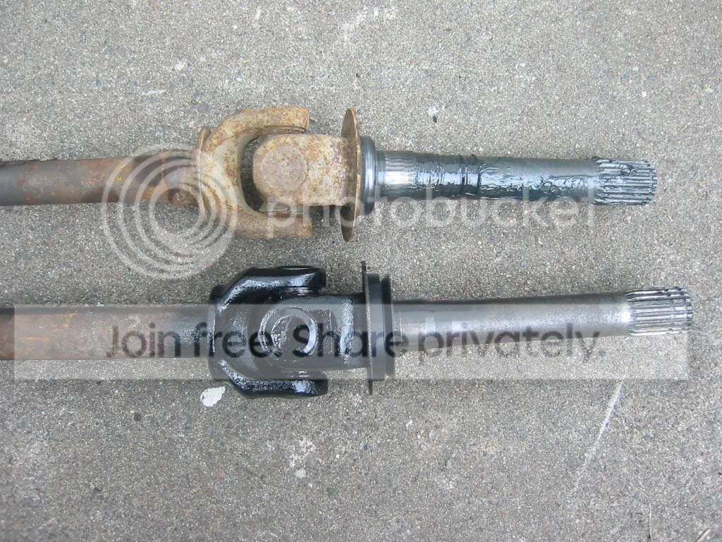

Here are a few pics if a '71(disk brakes) and a '77 D44 axles. The ones you show in your pics look like they could be from a disk brake axle......not sure.
The thicker axle with the painted yoke is the '77. You can see that the seal surfaces on the axle are different and the seal on the end of the spindle is different as well. ;)
Don't forget that the older axle has the small 260x u-joints and your '77 axles have the 297x u-joints. :D
thats funny the outter is still differant??? if some one could can u take some calipers and measure the where the inner axle seal rides and post it. the one i have is 1 5/16" thx
