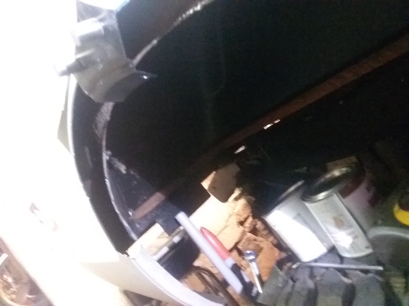

Been a few months but I did some work patching the rear quarter panel wheel arch. I picked up one of those harbor freight shrinker-stretcher kits to build this patch panel. The part I cut off is in my hand and the replacement is welded in.
Still practicing TIG, still need a lot more practice. I’ve got some other non k5 projects going on so it’s slow but weather is warming up so I’d like to drive it. It’ll need to spray some primer on it to avoid rusting while the next repairs are waiting.
