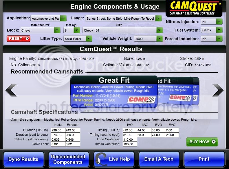

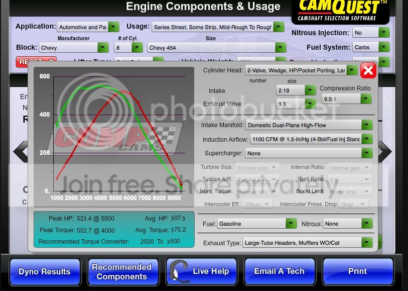

Finally got the tranny wrapped up and shipped off to @Greg Ducato. I owe him a phone call to talk thru the details since I'm doing a cam swap AND need a higher stall converter.

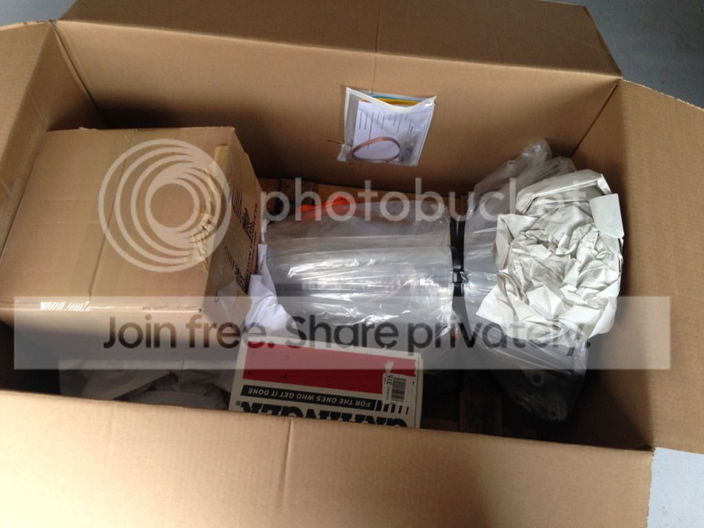

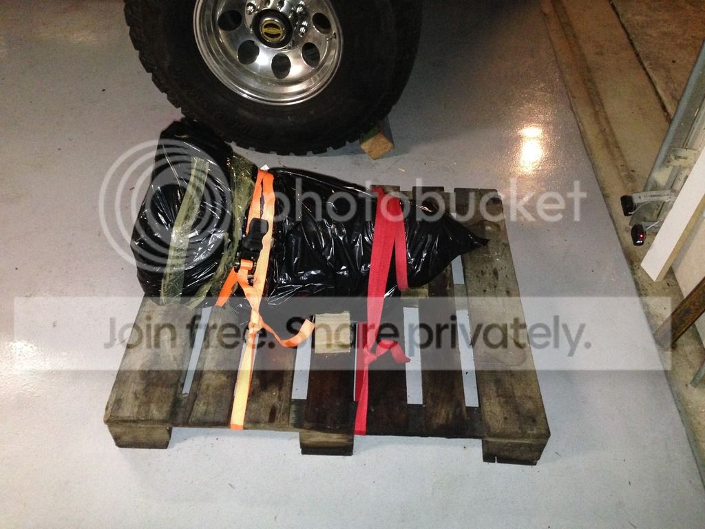

Got the call this week that the rebuilt tranny, built to the Phoenix ST spec, was ready to be shipped. Picked up a pallet crate today:
Transmission, 2500 stall converter, and the lockup controller. Heck, they even packed the ratchet straps that I used to ship the other one.

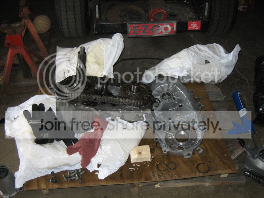

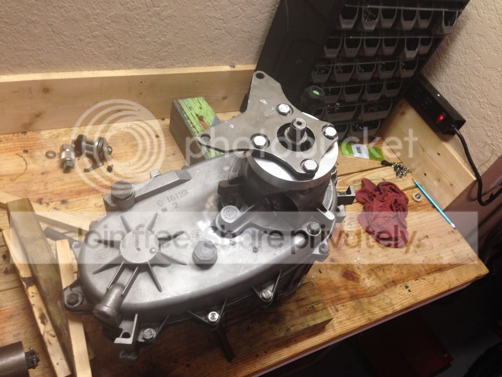

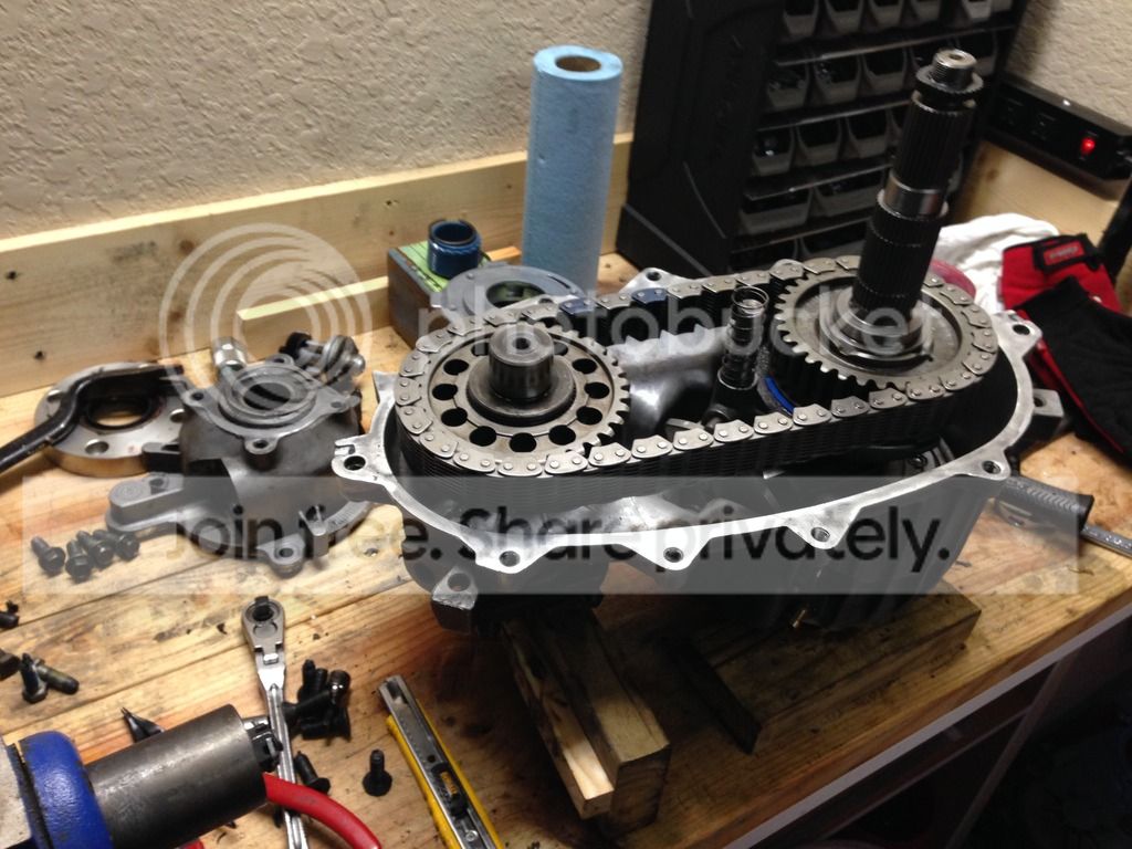

1/2/16 - Getting back to work and a little build gore. I took a break for a couple of months from the truck to do some stuff around the house. But with the holidays done, it was time to hit the garage to tear down and reseal the leaky 241.
Tore it down...actually tore it down almost to bare case to replace all three seals...just forgot to take that pic
I was a bit more organized this time than the last time I did this. My own garage and workbench made a huge difference. For reference, when I first did the SYE, I was working on a shipping pallet with packing foam holding it "steady".

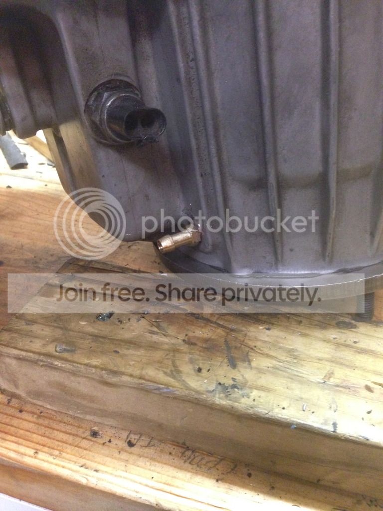

Tapped a new NPT breather nipple because the old one leaked where it inserted into the case.

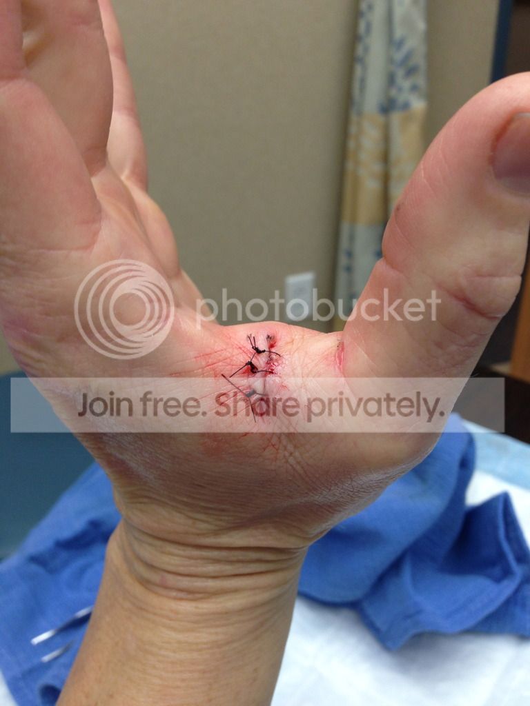

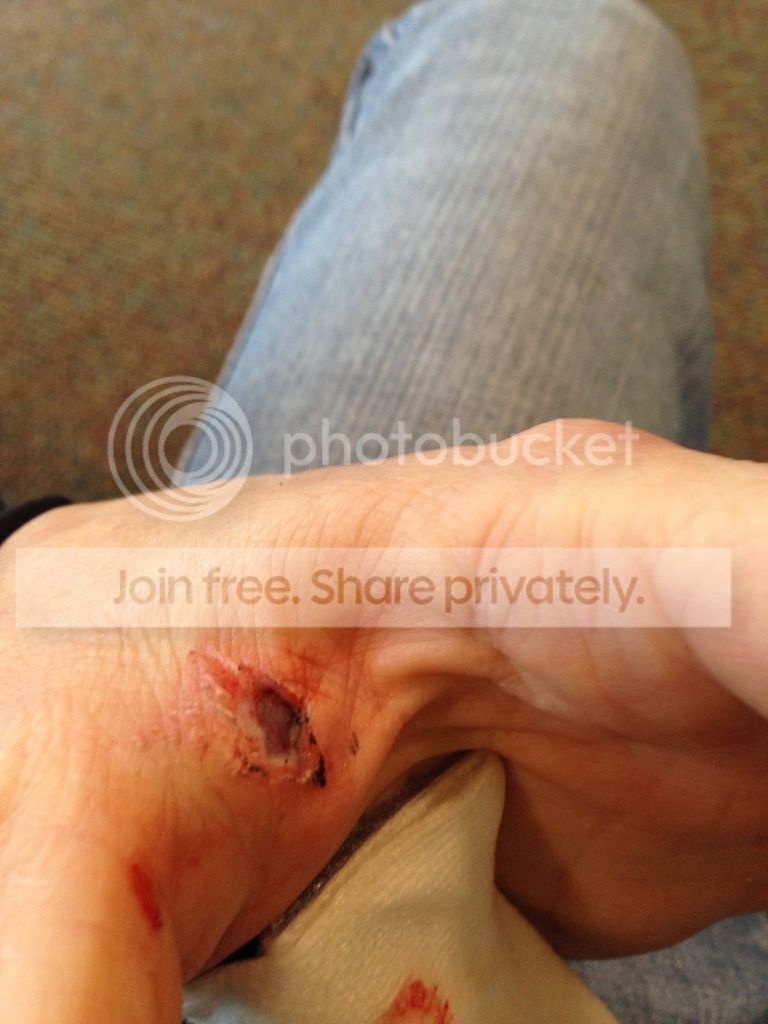

When I removed the pump, I stripped a couple of the phillips screws and had to drill them out. Wasn't able to find the correct length at Lowes (8-32 1/2") so I had to cut down a couple. And that's where the fun today started. Managed to catch the thumb webbing on my left hand with the grinder.
Would've taken forever to heal there and I could see inside my palm. So, three stitches later
Hour and half later.....back in the garage to get it all buttoned back up
Check that off the todo list. Fuel line heat shield is next.
For anyone searching for 241 seal #s, including the SYE rear seal (Napa part#s):
Input: NOS 19255
Front output: NOS 18771
SYE Rear output: NOS 18658
That's the spirit! Right back to work. Sounds like you have the same thought process as me. If I think it will heal with it being used...forget the doctor! But you had no choice.
