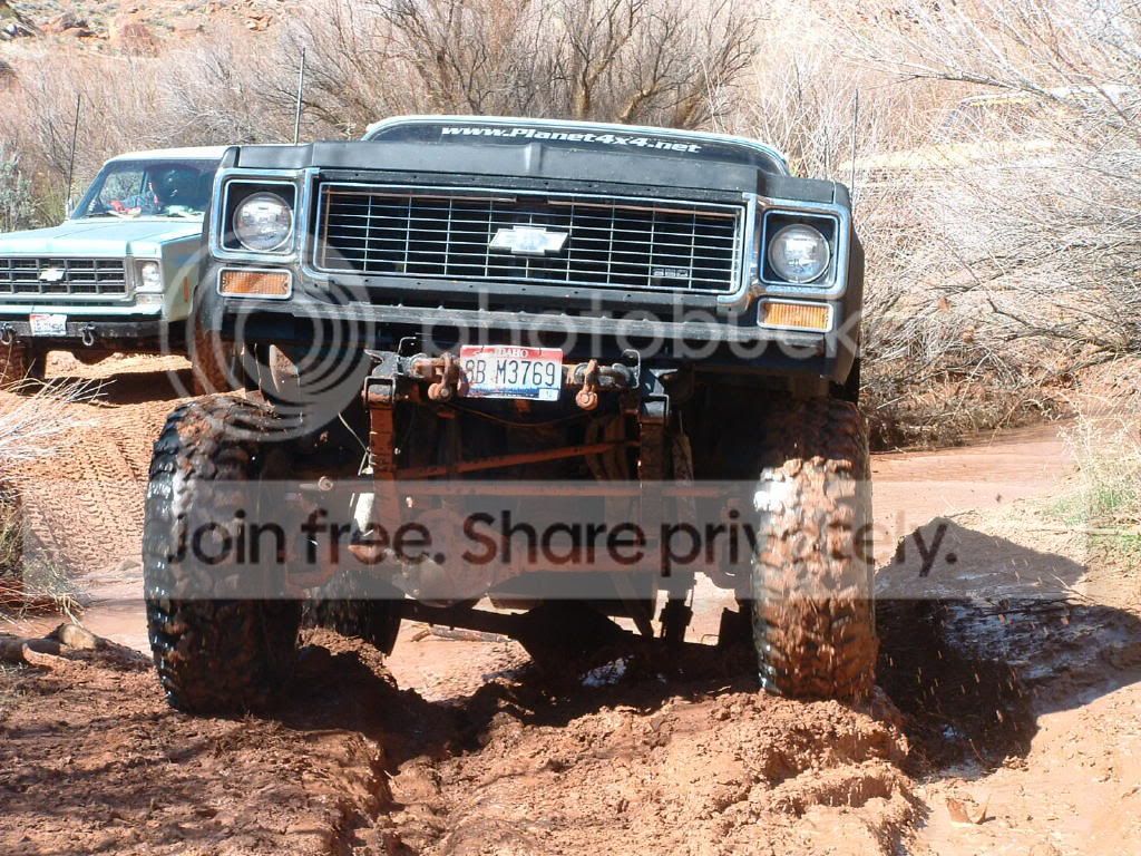

anyone tell the actual year from this lousy angle?
