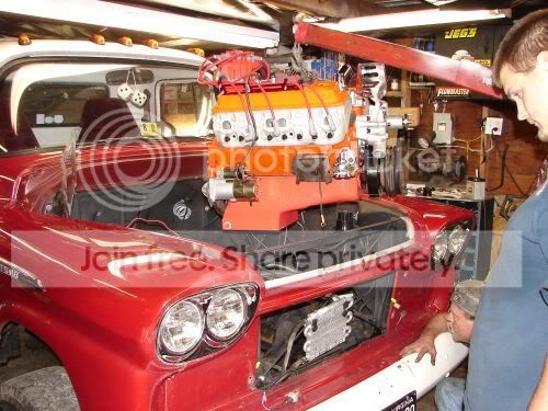

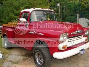

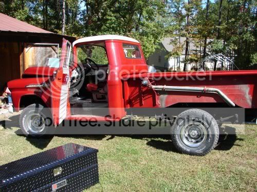

heres mine.. its on 85 frame. had to resize frame and put 3" body to clear bell housing. runnin a 406 sbc th350 np208 just got a 14 bff 31's now but have 37's for after the 6' lift
