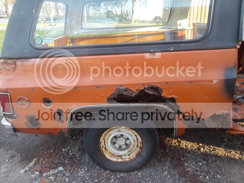

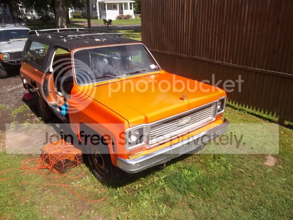

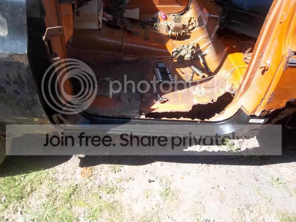

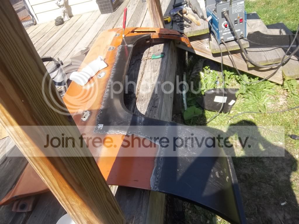

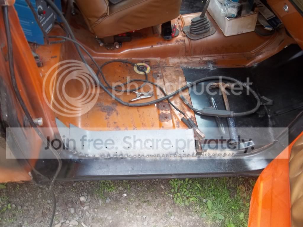

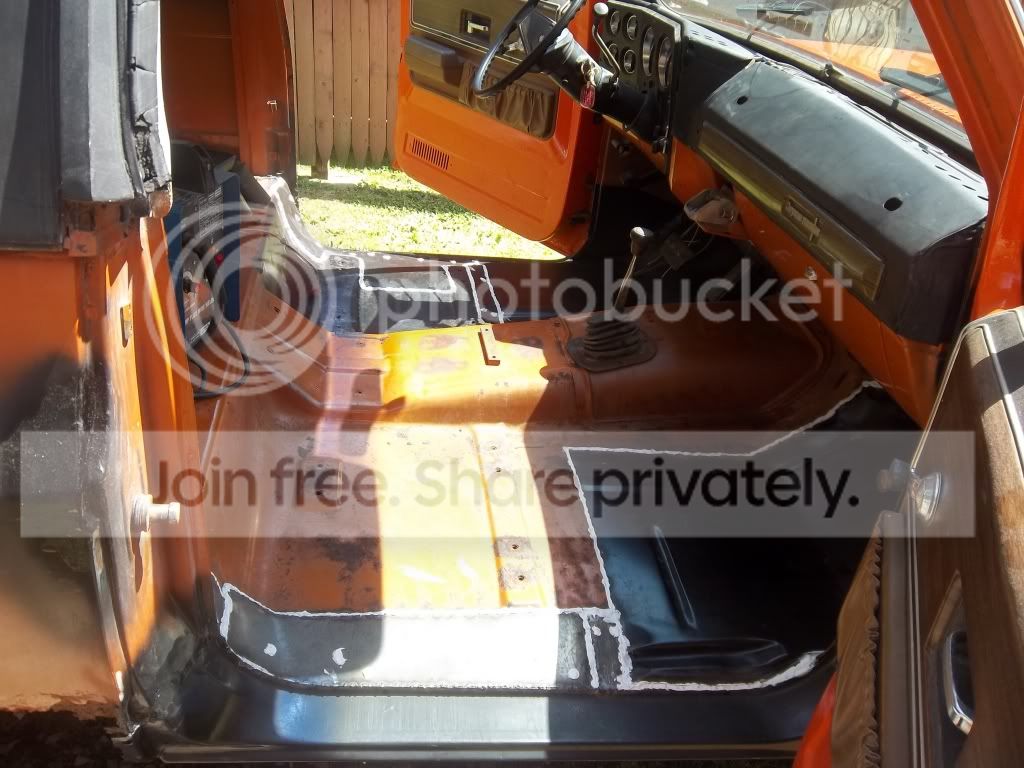

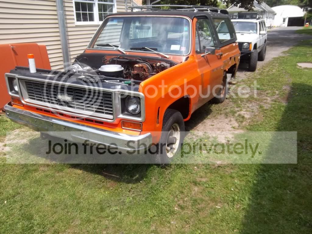

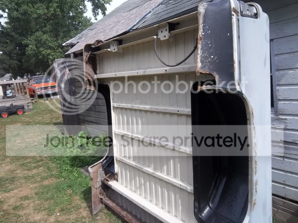

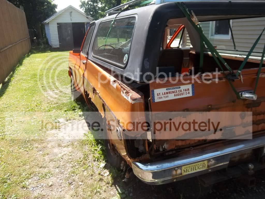

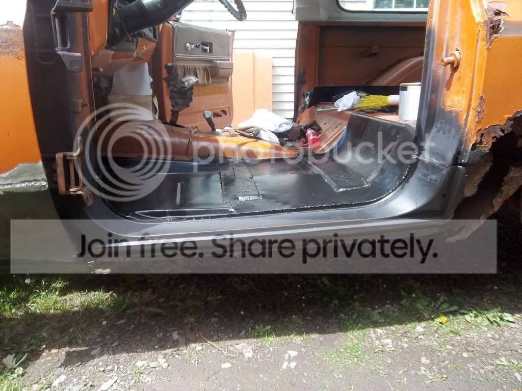

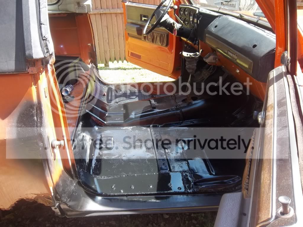

gonna replace the rear of the tub with the bed of a short box and weld in place. dimensions are the same.got this truck 5/12 and this is whats been done to date. hope to have it completed by the first snow fall. i live in Waterloo NY
Great progress and plan dude! Glad to see someone putting a rust bucket to use by replacing stuff instead of just scrapping it out like most would :thumb: So are you going to chop the box and put the topper back on some how? Or just replace the quarter panels with the bed sides?

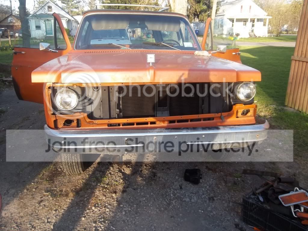

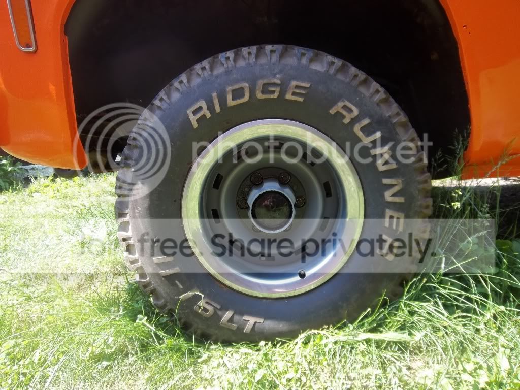

love the Rally's all cleaned up

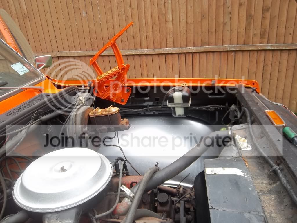

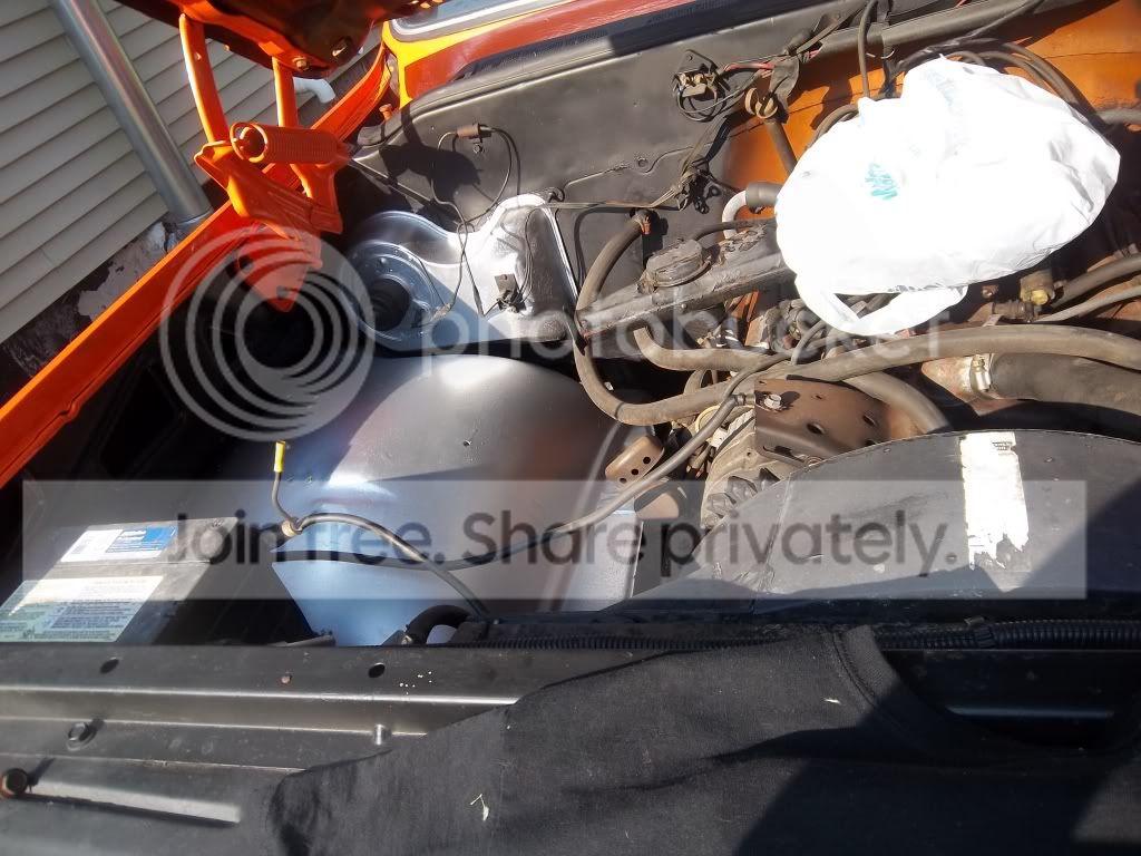

little clean up in the engine bay

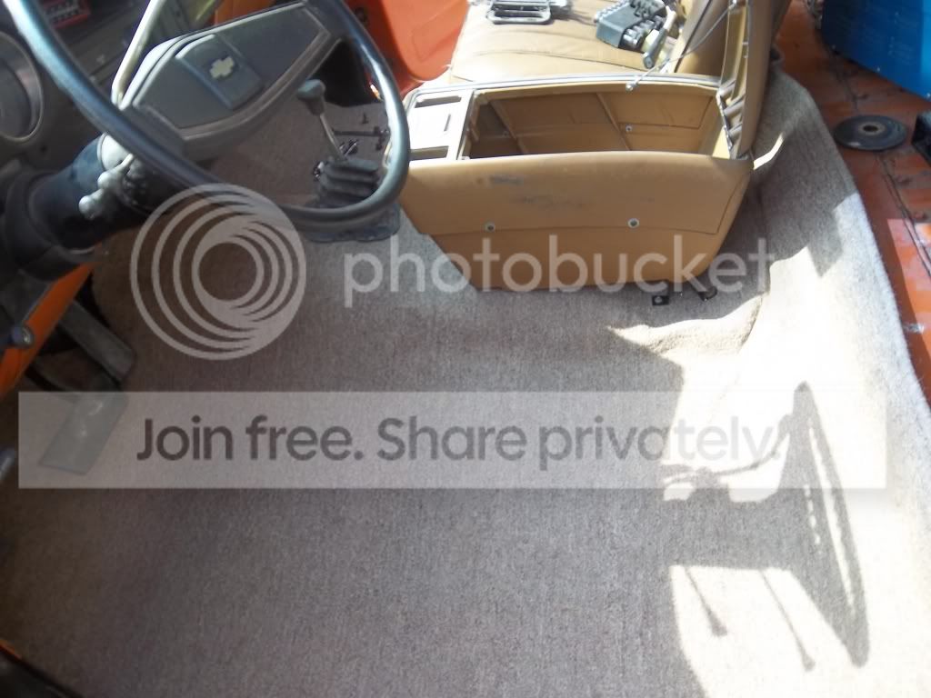

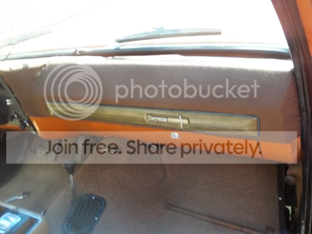

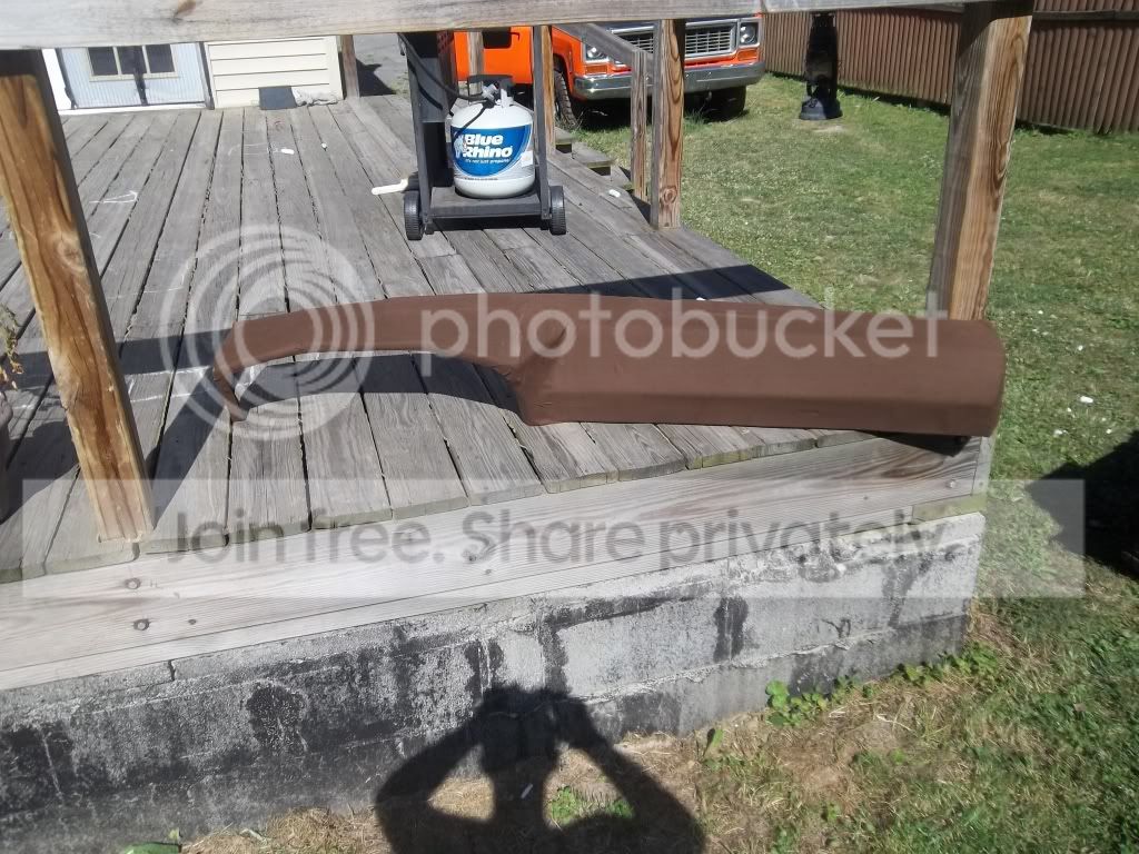

covered the dash in canvas
a lil (a lot) celibrating after i got the work done from the door to grill completed

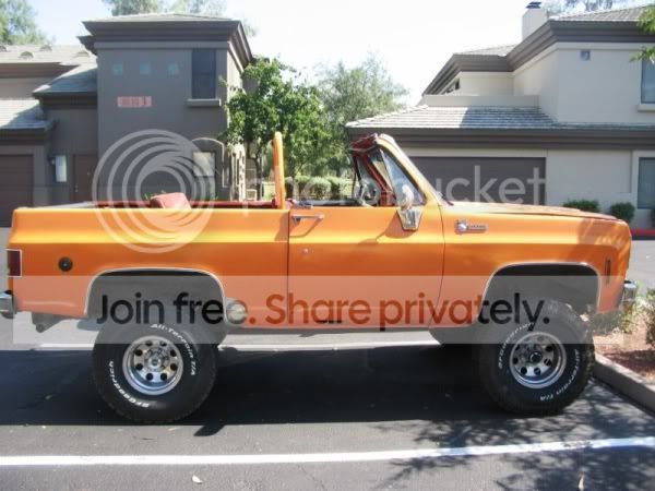

my 1st 73 K5 in AZ. 350, TH350, 208, 10 bolts shame i ever sold it

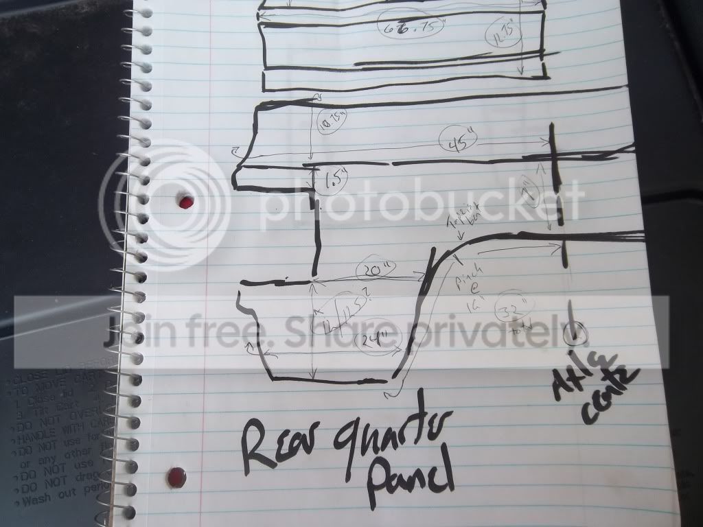

yeah the idea is the dimensions from the center of the axle/wheel well are identical from a 73-91 K5 as they are for a 73-87 Short Box. from the axle cent forward is longer which is no problem cause i'm gonna cut off the excess ans weld to the original door jams. basically replacing the rear floor and both sides all it once. few small issues like fuel filler relocation and losing the glass form the old K5 tailgate for a P/U tailgate (fix by attaching a truck cap window to the fiberglass top like a 1st gen.) but in theory the whole idea should work. nothing a cut off wheel and fire stick can fix, oh yeah beer... gotta have lots of beer when doing this.

What color is it. I am kind of partial to orange.
Just you wait n see :popcorn:
