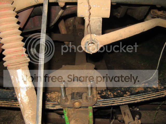

That brings it up to today when I started to play musical chairs with the front springs. The 4inch rough countrys are coming off and going on the crewcab and 52s off an old suburban I used to have are going back on the green truck.

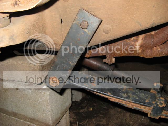

A while back I read a thread about someone doing a 52 swap without relocating the rear spring hanger? Im trying it.:doah:
Right now I've got one side mocked up with a 7inch on center shackle. To satisfy my own curiosity I tried it in the stock front location. Even with no weight it has a wicked negative shackle angle.
Took some pics for giggles.
I've got almost all the material for the adjustable front spring hangers and the winch mount. Should have it mostly together next weekend.
