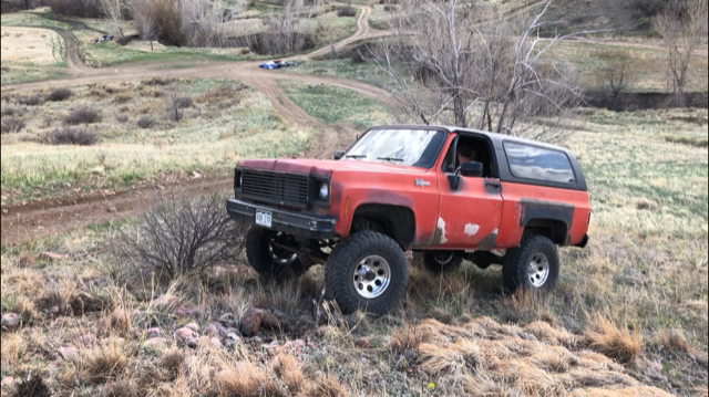

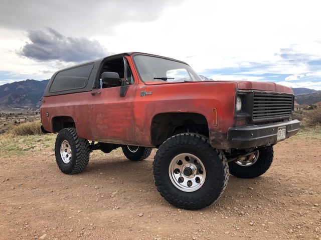

Friend! So following up on our previous thread, I successfully swapped out the brake lines AND got a brand new set of 36" wheels and Toyo M/T tires on it - looks amazing!! See pics
